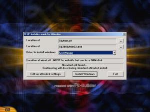

who wants a screenshot???
the top is the main window, the bottom is 1 of the edit winnt.sif dialogue..
