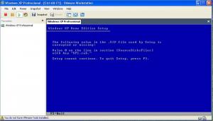

ClauSoft Posted June 14, 2004 Posted June 14, 2004 I've slipstreamed SP1 on my XP HE CD (worked fine..) and I've put HE on my multi boot DVD but when I'm trying to install HE from the DVD says SP1.cab found 0 value in *.sif file (I will attach tomorrow the picture with error). The installation stops in the moment when it supposes to start to copy files from the DVD to the hard drive.I'm using a RAID array but it is not working even if I try with WMWare (with no raid installed on my virtual machine..of course)It is very strange because if I burn only the image containing HE directory + boot sector of HE everything is fine.I must also say that the boot sector points exactly into the directory SETUP\xp\HOME where are my files for HE. So it is not a boot sector problem.Do you have any idea?
ClauSoft Posted June 18, 2004 Author Posted June 18, 2004 This is the message received when I'm doing the ISO for the full dvd (I mention AGAIN that if I'm making the ISO only for the XP HE SP1 folder it works...)

ClauSoft Posted August 5, 2004 Author Posted August 5, 2004 First of all...the language for this forum is English, if you want to say something in Romanian..feel free to use PM.D And YES, I've made AIO-DVD and the size is about 3Gb.I repeat: If I'm using ONLY one or two OS it works fine. Probably you're right, it is a problem that the image is bigger than 2Gb. How can I solve this problem? CDImage claims to support DVD images (that means the image could have at least 4.3Gb, of course) :
