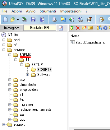

This is the "setupcomplete.cmd" script that I have always uitilized.
Sincerely thank you

Setupcomplete
@echo off
SET CDROM=%WINDIR%\Setup
REG ADD HKLM\SOFTWARE\Microsoft\Windows\CurrentVersion\RunOnceEx
SET KEY=HKLM\SOFTWARE\Microsoft\Windows\CurrentVersion\RunOnceEx
REG ADD %KEY% /v Flags /t REG_DWORD /d "20" /f
REG ADD %KEY% /V Title /D "Post Installation..." /f  >NUL
REG ADD %KEY%\06 /VE /D "Calcolatrice Legacy" /f  >NUL
REG ADD %KEY%\06 /V 1 /D "%CDROM%\Software\Calcolatrice_Legacy_2.0.exe" /f  >NUL
REG ADD %KEY%\42 /VE /D "Deleting Setup folder" /f  >NUL
REG ADD %KEY%\42 /V 1 /D "%CDROM%\Software\Deleting_Setup_folder.bat" /f  >NUL
EXIT
