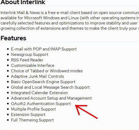

Guest Posted August 29, 2020 Posted August 29, 2020 (edited) From 20 October, anyone with a Yahoo e-mail account will have to set up OAuth2 authentication in the e-mail client. To do this you need to enter the client app and generate a password as shown in the figure below: With MailNews the operation is OK. When I open MailNews I can use OAuth2 With Thunderbird 52.9.1 it doesn't work, there is an error. If any MSFN users who has a Yahoo account wants to take a test and report in this topic if they have different results than mine. Thank you all. ********************** P.S. Now, after a reboot of PC, MailNews doesn't work. Some problems with ImgBox. Edited August 29, 2020 by Sampei.Nihira

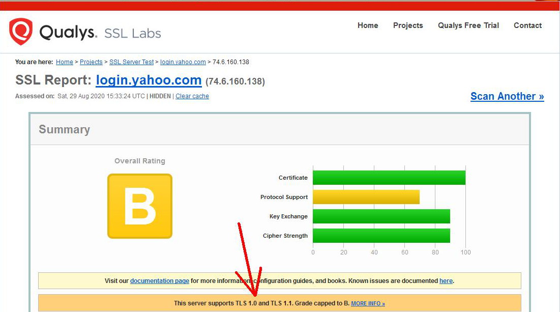

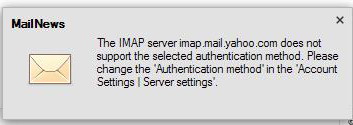

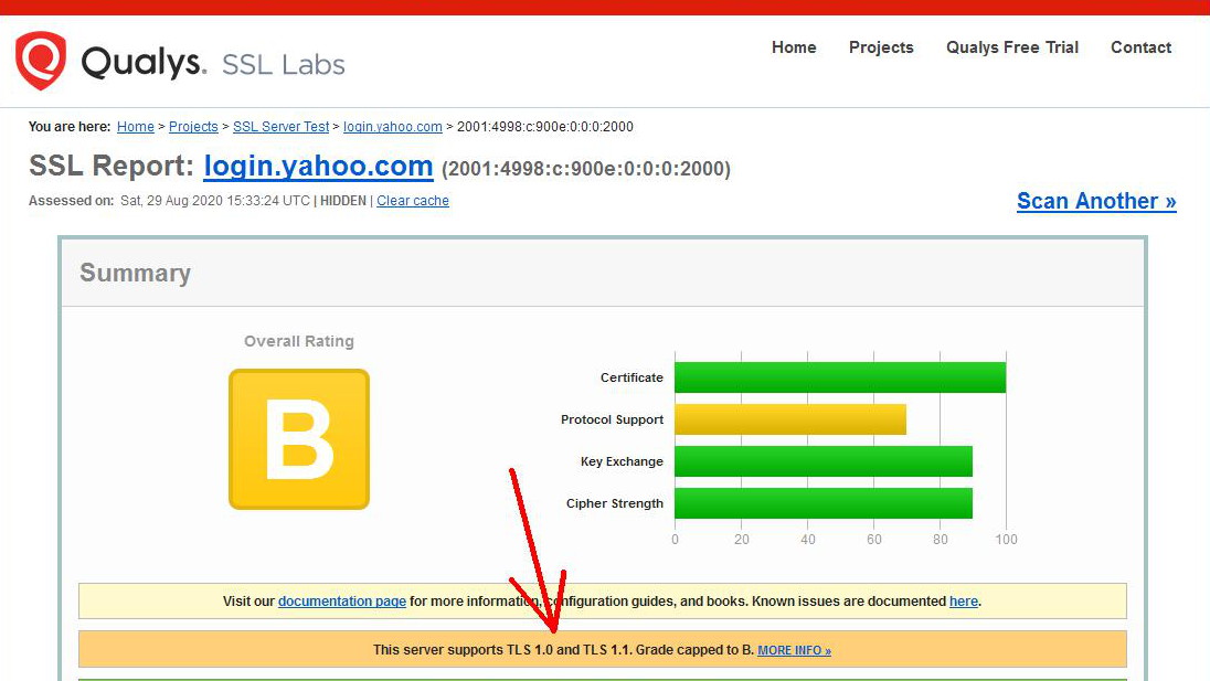

Guest Posted August 29, 2020 Posted August 29, 2020 (edited) Hi, thanks for your contribution. Qualys test shows that both servers support TLS 1.0 and 1.1: photo upload gif upload site And MailNews supports OAuth2: but when I enter OAuth2 an error message says this protocol is not supported by the IMAP server. temporary image hosting I tried in the pc with Win 10 and Thunderbird v.78.2.0 and there are no such problems. Edited August 29, 2020 by Sampei.Nihira
Dave-H Posted August 29, 2020 Posted August 29, 2020 That's good to see, but don't depend on it staying like that! There's evidence that Yahoo and others are gradually updating the requirements on their servers, and all the servers will I'm sure start rejecting TLS v1 logins eventually. I'm using yahoo.co.uk servers which already reject TLS v1 logins.

TMI-NY Posted August 30, 2020 Posted August 30, 2020 On 8/29/2020 at 11:57 AM, Sampei.Nihira said: but when I enter OAuth2 an error message says this protocol is not supported by the IMAP server. temporary image hosting I tried in the pc with Win 10 and Thunderbird v.78.2.0 and there are no such problems. I also got the AOL-Yahoo Oct 20 notice... I am seeing the same error here for my AOL IMAP accounts, MailNews latest, and Vista32. I tried to remove and re-add the account or just manually switch from Normal password to Oauth2. And MacOS and latest Tbird are working with AOL Oauth2, just as a test to make sure my account is functioning properly on the AOL side. @roytam1Thanks so much for New Moon and MailNews!!!
Guest Posted August 30, 2020 Posted August 30, 2020 (edited) act8192 reports on W.S.F. that it has no OAuth2 authentication problems with SeaMonkey. Probably the same is achieved with IceApe-UXP Suite (topic - My browser builds by Roytam1). Any MSFN member who can take this test? That will not work. The version of SeaMonkey that act8192 uses has the same specifications for the email client as Thunderbird 60. The first version compatible with OAuth2 and Yahoo Mail. P.S. I found the code for OAuth2 + Yahoo that was added in Thunderbird 60. I ask @roytam1 if porting to MailNews is possible. Edited August 30, 2020 by Sampei.Nihira
