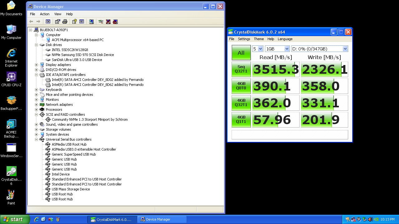

I ran a quick test this evening, installing Windows XP 64-bit on the ASRock X99 Extreme4 mainboard I use for Windows 2000 Professional.  I ran nLite 1.4.9.3 to integrate 5eraph's update pack and IE8 Addon, and Fernando's AHCI SATA and sSATA drivers.  I tested Microsoft Update to get the .net frameworks and updates, just to see that it (MU) worked okay.  I think the screenshot has all the other information.  The OS installation and so forth was trouble-free.
I have no plans to pursue this further for now, but wanted to post this brief FYI before I button up this hardware with W2K Pro.

I tested "Community OFA NVMe 1.5 Storport Miniport for Windows Server 2003 R2 SP2" by Kai Schtrom, using Samsung 970 PRO M.2 2280 512GB PCIe Gen3. X4 NVMe 1.3 64L V-NAND 2-bit MLC Internal Solid State Drive (SSD) MZ-V7P512BW as secondary (storage) drive:
I don't know XP x64 very well, and know nothing about Windows Server 2003, except that the internet says they are structurally similar.
Kai Schtrom's test involved Windows Server 2003 x86 rather than x64; however, his files include a 64-bit version as well, which was used here.
