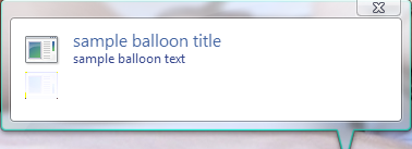

Even though I use GlassToasts64.exe -auto to hide the start dialog it still shows at every start. I mean this:

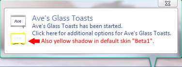

The other bug is that the shadow reflection are yellow in start dialog and in skin "Beta1". But it's not yellow in the other skins. Can it be fixed?

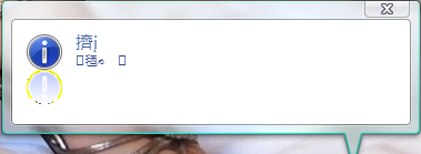

Edit: Found third bug that appeared after I put GlassToasts in autostart and restarted computer. This dialog shows several times during startup:

I know about some of these issues, it was late and had some other things on my mind. Was going to write about them here anyway.
That's actually a "bug" in the Readme which I haven't updated (yet), the correct parameter is -silence
Yes, this one is the most bizarre and only happens in x64 version and only with default skin for unknown reason.
Strange, can't reproduce this one.

Tried with -silence and it works for me now. :)
The yellow shadow is very strange so I will probably use another skin. More skins can be found at https://www.deviantart.com
I don't know why the "sample" dialog shows for me. Maybe it's related to any other program I have in startup because it only shows at computer startup but never later.
Not strange at all after you realize that the program's code for handling messages passed to notification area is flawed. Depending on how programs are coded, GlassToasts could even prevent them from showing an icon in notification area...

It hasn't prevented any of my icons to show in tray so far and I have about 15 icons there. The most annoying thing is the "sample" dialogs that shows maybe 5-6 times at every startup.
So if that's possible to fix it would be great but otherwise I can add a delay to GlassToasts startup so it starts maybe 30 seconds later and then I will not see any "sample" dialogs any longer.

Do you still get those random notifications with the updated version?
BTW, I did a test; I compiled modified 32-bit version and tried invoking the code for displaying notifications. Guess what, those yellowish glitches we've discussed showed up! As long as it runs on 64-bit OS, they show up.

Just tested the new version and now I didn't see any strange dialogs neither at startup or shutdown. :worship:
But that yellow thing is very weird, especially since it only shows in default skin and not in others. :unsure:
