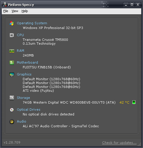

Sudos Posted October 26, 2016 Posted October 26, 2016 I have a Fujitsu Lifebook P2110 ultraportable from around 2002-ish. it's based around a Crusoe TM5800 867MHz, 256MB of PC133 (and a MicroDIMM slot for another 256 stick, very expensive) and an 80GB WD WD800BEVE drive (plus two batteries.) GPU is based around a PCI-connected Rage Mobility P with 8MB of VRAM. the P2120 model of this machine has the same CPU but I believe at either 867 or 1GHz, and a Mobility Radeon (7000). XP SP3 runs absolutely wonderful on this machine, for its age, and slowness (akin to an early PII). However, when I try to install Windows Fundamentals for Legacy PCs on this machine, it gets through set-up, and at the bootsplash right before it's supposed to start doing configuration through the First Boot Agent, the machine bluescreens. Going through setup again and pressing F7 to disable ACPI also does nothing. in a similar attempt, I've also tried using a different machine as an installer and then forcing drivers so to get a working install made correctly for the machine, and it still bluescreens. I'm not sure if this machine is just incapable of using the kernel that FLP comes with, and since I've not been able to find out if POSready 09 comes with the same kernel or not, I've been sticking to just normal XP on this thing. I know exactly how FLP should perform on this machine, having done an install on a Pentium II 233/256M/40GB box back around 2009 and video documented the results. I've been toying with the idea of picking up one of the sightly more standardized HP Thin Clients which make use of the same CPU but with DDR RAM so to see if the problem is with the machine or the CPU itself. is there anyone out there that still has a thin client, all-in-one or laptop with a Transmeta Crusoe that'd be willing to do a test install of WinFLP or POSready 09 to see if it's possible at the very least? All Google-Fu queries turn up nil, and I don't know if it's just me or if it's just not in the design.
