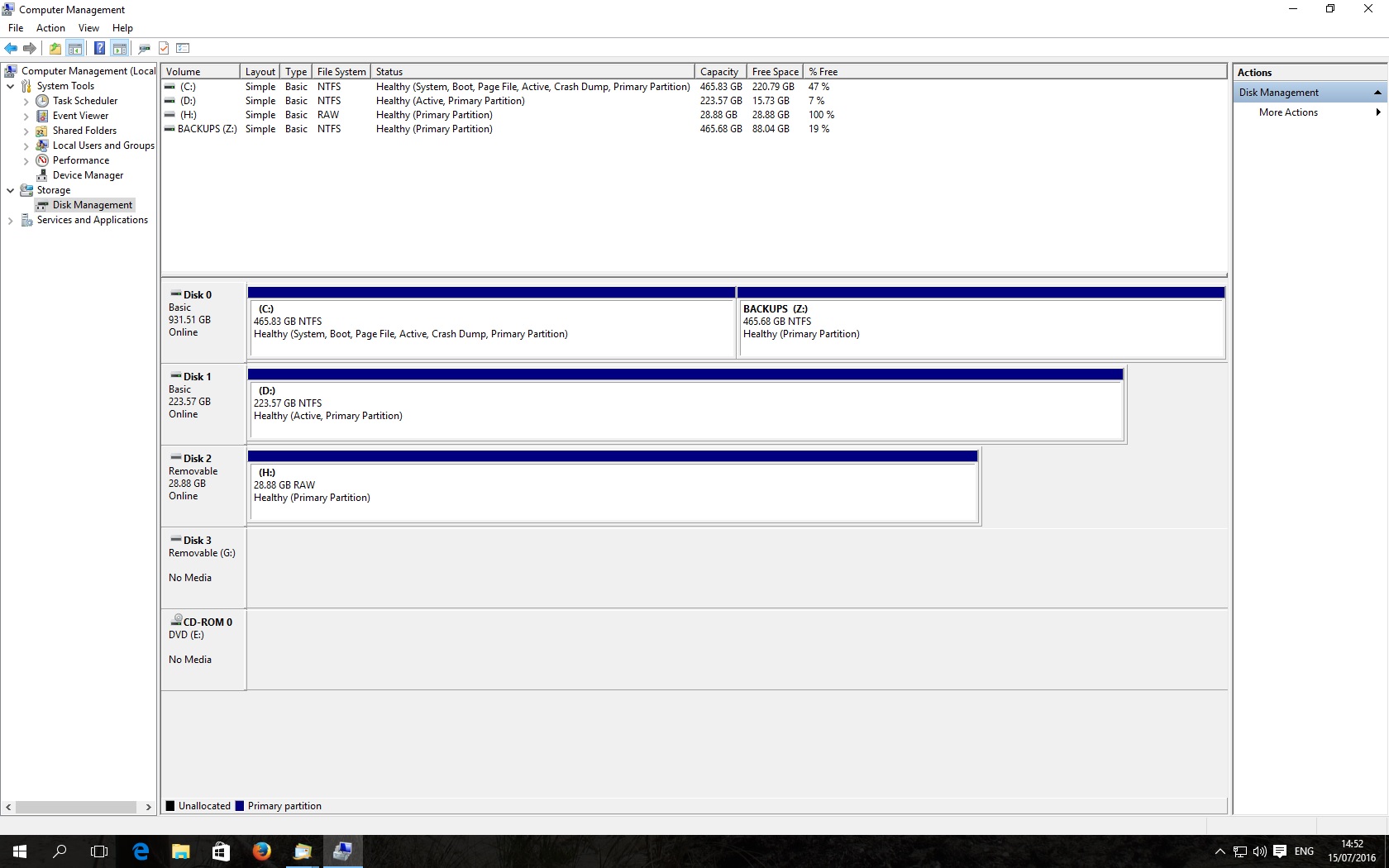

red fox Posted July 21, 2016 Posted July 21, 2016 Hello to all, my first posting.... I've seen a few discussion on the forums regarding USB flash drive access problems and I have tried to follow various suggestion in them, but unfortunately have failed to reach a successful result at the moment. Just over a week ago I was working on my computer and managed to successfully save information to my Intergral Neon 32GB USB 3.0 Flash Drive which I have been using successfully up to this point I didn't use the computer/Flash drive the following day but when I powered up the computer and inserted the Flash drive I got the "You need to format the disk in drive H: before you can use it." " Do you wish to format?" Obviously I declined and found that my flash drive was now reporting that it was 28.88GB RAW Healthy (Primary Partition). I have tried several 'recovery' tools but none seem to help me get to the root of my problems. I have getting on for 3yrs of data on this drive and unfortunately the last backup I have is well over a year out-of-date. That will teach me to back up more often!! If someone could advise me on the best method to follow which may allow me to recover my flash drive I would be extremely grateful. Many Thanks
