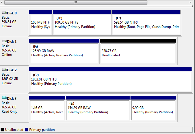

rcll Posted May 21, 2013 Author Posted May 21, 2013 (edited) You're right of course Jaclaz.I found finally the encryption is Mcafee. I have password now and was able to use 'Mcafee emergency disk' to write the bootsector. Now there is encryption password prompt when booting up like it used to be, I enter password and it accepts it, but then it says 'cant load OS'.Do you think there is a way to restore the HDD so the encryption software can recognize it as encrypted? so it can then decrypt it?Here is how the HDD looks after Mcafee emergency disk repair:It is Disk 1 with 126GB partition and the rest unallocated, which is not correct.Compared to Disk 3 which is image file of same HDD before emergency disk repair, showing 3 partitions, but probably those are not right either. Usually system is 100MB not 1.46GB right?What do you think can be done to see some files of this disk? Edited May 21, 2013 by rcll

jaclaz Posted May 22, 2013 Posted May 22, 2013 It is Disk 1 with 126GB partition and the rest unallocated, which is not correct.Yes, but usually (cannot say specifically) there is an option in the encryption software to "convert" the encrypted disk to non-encrypted without booting it.I am not familiar with McAfee encryption software, and there are more versions of it than stars in the sky, if I recall correctly, how exactly did you write the bootsector?Maybe the emergency disk "unencrypted" the existing bootsector (which was altered before) instead of replacing it with the original one.But the partitioning would never be affected by any change to the PBR or VBR or bootsector, if the partitioning layout changed it means that the McAfee Emergency disk changed the MBR! Still following - no offence intended towards the guy that encrypted that disk, that surely did that in perfect good faith - my theory that on average users of encryption solution don't know enough about data preservation, it could be that what was given to you was the recovery disk generated on another machine.I mean, a "normal" MBR (and/or PBR/VBR/bootsector) is made of two parts, code and data.It is possible that the *whatever* the emmrgency disk wrote was the "right" code (generic) but the "wrong" data (belonging to another machine). Compared to Disk 3 which is image file of same HDD before emergency disk repair, showing 3 partitions, but probably those are not right either. Usually system is 100MB not 1.46GB right?Yes, but 100 Mb is the "default" for Windows 7, an OEM (like Toshiba) might well have decided that a larger one was needed/smart/whatever.Out of the three partitions 1st and 3rd were OK, so I doubt that What do you think can be done to see some files of this disk?You need to check if Mcafee (or a third party) provides a solution to "convert the disk" to unencrypted (without changing/restoring/whatever) the MBR or the bootsector.jaclaz

jaclaz Posted May 23, 2013 Posted May 23, 2013 Well, you are back to #1, so seemingly the (put here any adjective heavily offending your customer's mental capabilities) guy provided you with the wrong disk? However, nothing prevents you from re-writing ONLY the (good) DATA of the MBR you had before on the current MBR (which has now the McAfee CODE).Of course IF part of the CODE contains a form of checksum, it won't work, but trying doesn't harm anyone.In a MBR offsets:0-445 Code (including Disk Signature on Windows NT OS at bytes 440-443)446-509 DATA partition table, 4 parttiion table entries, each 16 bytes510-511 Magic bytes 55AASo basically you have to copy bytes at offsets 440-443 (4 bytes, the disk signature) and bytes 446-509 (48 bytes, the partition table) from the "old" MBR and replace the corresponding bytes on the "new" McAfee one.Next step would be to create THREE copies (images) of the disk, wipe (write with 00's) the area where the "middle missing partition" is, then format with the same OS originally used (I believe 7) the "missing partition in the middle" as NTFS, then attempt installing the encryption using the same keys.Then compare the three of them, two at a time.If they result (at least the first few sectors) substantially similar, then you may have a chance.Explanation:When you format two filesystems you do it (obviously) one after the other, the result is that the freshly formatted filesystem will never be identical, because the volume serial (which is misteriously created by the OS on a semi-random base) will be different and expecially on NTFS filesystem structures will have different timestamps.The point is if the encryption algorithm (the "initial loading part") uses just the provided keyfiles and/or password or it uses a "salt" based on "specific data":What you can reproduce is:size of the volumeposition of the volume of diskcontents of it's first few sectors (but not the volume serial)if anything else (like the volume serial or current date/time or date/time of any filesystem structure) has a role in the encryption algorithm yu will have different results (and thus you won't be able to recreate the original "headers").There is a possibility, still, (again it may depend on the exact version of the software used), at least in older releases there was the possibility of accessing a ("sound") encrypted volume without original key and password by using a "tech access" and a "daily code" (or something like that).Such an approach may work even with the headers of a "different" volume, but it is really hard to say. JFYI :jaclaz
