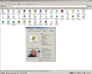

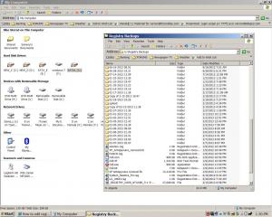

Gibbs Posted March 8, 2013 Author Posted March 8, 2013 (edited) Thanks for the tip on registry cleaners. I DO use a program called ERUNT every once in a while and save the regsitry to another hard drive. Basically it creates a new folder with the date and backs up the registry with an option to include other users into that folder. If you ever have to restore a particular registry, you go to that "folder" and select the ERUNT icon and run it. It restores the registry in a process that requires the sysem to shut down. Google ERUNT sometime to see what I'm talking about. I have registries saved up back into June of 2012 in that one folder "Registry Backups" on my one internal HD.EDITED to include those 2 zip files attached below:WINLOGS.zipWINUPDT.zipEDIT: The System jpge... which I could have gotten by right clicking on My Computer on desktop. Or AIDA32 I think has a very big section on what's what.I've actually have had this problem as far back as the end of Jan, 30th and if you see the registry backups there in early Feb was when I was still having some place to "Go back" to. Edited March 8, 2013 by Gibbs
