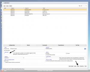

husein93 Posted February 14, 2013 Share Posted February 14, 2013 Helo I have one question how to make WPI to install programs this order (1,2,3,4,5...etc (example) ) there is a picture what i do but it seems I doing something wrong or its maybe a bug ? Thank you for reply ! Link to comment Share on other sites More sharing options...
myselfidem Posted February 14, 2013 Share Posted February 14, 2013 Give an order number for all other applicatons! Link to comment Share on other sites More sharing options...
husein93 Posted February 14, 2013 Author Share Posted February 14, 2013 Give an order number for all other applicatons!I try that too but it doesn't work Link to comment Share on other sites More sharing options...
