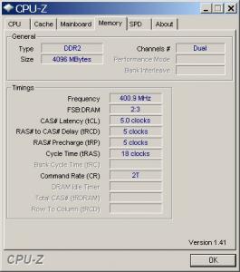

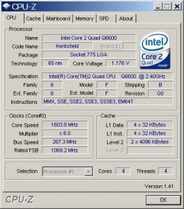

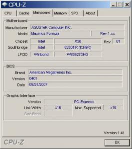

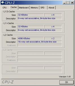

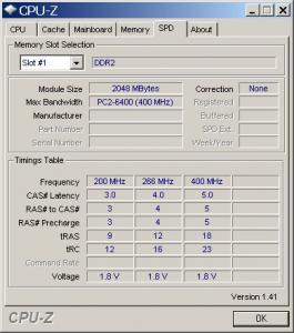

See the attached images from CPU-Z showing my system specs
I ran the Microsoft compatibility software on my system (this was for Win 7 64bit) and it said that my installed software was 64 bit ready -
Would that diagnostic say that about 32 bit software?
Thanks again for your much needed help
If this undertaking is totally unfeasible, I'll just keep running with what I have
My system specs =
post-358169-0-05798700-1342173870_thumb.post-358169-0-13003800-1342173901_thumb.post-358169-0-85833800-1342173930_thumb.post-358169-0-80159900-1342173979_thumb.post-358169-0-07802600-1342174013_thumb.
