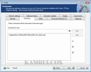

kali Posted April 24, 2012 Author Posted April 24, 2012 Thanks Geej and Sp0iLedBrAt Geej your links are very important. I did not use Office Integrator before. So I followed your advice "RunOnce" method. I added my Office2003 file in \$OEM$\$1\Office200. Then I added two files in Office2003 folder, Unattended.MST and Office2003_XP_Addon.exe (command line of office2003 setup). Then I added command line to run Office2003_XP_Addon.exe in Runonce section of Nlite. It runs office setup before appearing Desktop and performs installation successfully. So I have no problem to add Office2003 in my customize XP CD. I also tried to make Office2003 nlite addon using SFX Maker and it is my problem. Because it doesn't work as nlite addon. This addon/hotfix reduces Office2003 size in only 240 MB and works fine in normal windows. But shows problem when I add it as a hotfix with nlite that I mentioned at the top.
