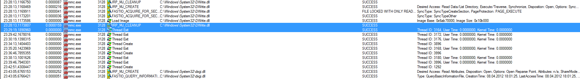

MagicAndre1981 Posted April 8, 2012 Share Posted April 8, 2012 run process monitor to see what takes so long to open services.msc. If you're unsure, save the trace as PML, compress it and upload it to your SkyDrive. Link to comment Share on other sites More sharing options...
fsantiago Posted April 8, 2012 Author Share Posted April 8, 2012 (edited) Ok I also took a pic with my phone since paint doesnt open right away and I cant screen print. This is what happens when I open services. It stays like that for a while.picLog Edited April 8, 2012 by fsantiago Link to comment Share on other sites More sharing options...
MagicAndre1981 Posted April 9, 2012 Share Posted April 9, 2012 this is the old PML. I would like to see the new PML with the data when you try to start the services.msc. Link to comment Share on other sites More sharing options...
fsantiago Posted April 9, 2012 Author Share Posted April 9, 2012 Oh my. Sorry I linked the wrong one. Here it is.Services Log Link to comment Share on other sites More sharing options...
MagicAndre1981 Posted April 9, 2012 Share Posted April 9, 2012 update the Mobile Intel® 965 Express drivers:http://downloadcenter.intel.com/SearchResult.aspx?lang=eng&ProductFamily=Graphics&ProductLine=Laptop+graphics+controllers&ProductProduct=Mobile+Intel%c2%ae+965+Express+Chipset+FamilyMaybe this this helps to show the MMC faster because the log shows some DWrite activaties during the gap:Also try to uninstall IE9 and go to IE8. Does this help?Also please look in the action center/reliable history, the LANmgr hang was detected by the Error reporting service. Look at the details of the entry. Do you get logs or hang dumps? Link to comment Share on other sites More sharing options...
