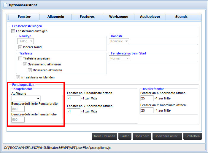

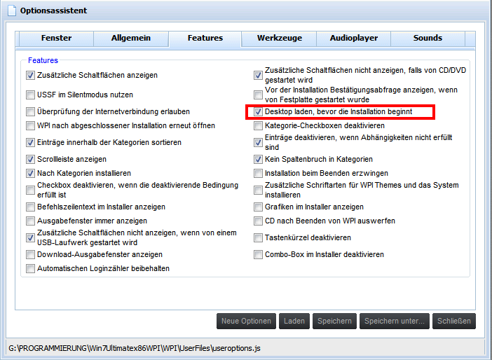

Sentionline Posted January 10, 2012 Posted January 10, 2012 (edited) Hey Guys!I have create an x86 Version and a x64 Version from Windows with integrated DriverPacks (All from Driverpacks.net). I use Autounattend.xml created in Windows System Image Manager. I have Add WPI (v8.4.6) to main Folder. Here is my Autounattend Selection for WPI start; <FirstLogonCommands> <SynchronousCommand wcm:action="add"> <CommandLine>net user administrator /active:yes</CommandLine> <Order>1</Order> <RequiresUserInput>false</RequiresUserInput> </SynchronousCommand> <SynchronousCommand wcm:action="add"> <CommandLine>cmd /c for %i in (C D E F G H I J K L M N O P Q R S T U V W X Y Z) do if exist %i:\wpi\wpi.exe start %i:\wpi\wpi.exe</CommandLine> <Description>Windows Post Install Wizard</Description> <Order>9</Order> <RequiresUserInput>false</RequiresUserInput> </SynchronousCommand> </FirstLogonCommands>I did already select, that Desktop must be load bevore WPI starts. The Problem is, Windows Logs in (Administrator) without loading desktop and blank Screen, starts WPI and Works....Works....Works. I wanna start WPI when the Desktop loading is complete. The definition in WPI is, that desktop is loaded when the User is logged in. Thats not correct. It loads, bevore desktop is complete. HDD Works 30 Minutes before it loads the Desktop complete. I have no idea why the HDD works so long.Computer Specs are;Intel P965 MainboardC2D E68502GB System MemGeForce GTS25080GB WD IDE HDD for testingAnother Problem is, that the Resulution of WPI in x86 Version is everytime 800x600. I have no resulution selected in WPI.Have anyone a Idea? I can Use AutoIt, but i have no Idea to fix these Problem(s). I did use Google and seach function for long time, without results.Greetings from Germany and thx 4 Help! Edited January 10, 2012 by Sentionline

Kelsenellenelvian Posted January 11, 2012 Posted January 11, 2012 Wow I barely know what is what in that. :SSample Music and Videos=True <-- Is this remove or allow?If it is remove then that COULD explain your resolution issue. Win 7 HAS to have those for the EI and will likely cause WPI not to be able to detect the resolution possibilities.Another Question:Did you remove\change anything in WPI? You should still be able to use the drop down box in the resoltuin section.
Sentionline Posted January 11, 2012 Author Posted January 11, 2012 (edited) Wow I barely know what is what in that. :SGo Slowly.Sample Music and Videos=True <-- Is this remove or allow?Allow. There is nothing. Is empty.If it is remove then that COULD explain your resolution issue. Win 7 HAS to have those for the EI and will likely cause WPI not to be able to detect the resolution possibilitiesIn my Autounattend.xml is defined; <Display> <ColorDepth>32</ColorDepth> <HorizontalResolution>1024</HorizontalResolution> <RefreshRate>60</RefreshRate> <VerticalResolution>768</VerticalResolution> </Display>Did you remove\change anything in WPI? You should still be able to use the drop down box in the resoltuin section.How to upgrade your WPI!Steps to update your WPI folder: Download and unRAR to a different location. From your old WPI folder, copy config.js, useroptions.js, and windowoptions.js from WPIScripts to the new WPIScripts folder. Copy your Audio folder from old to new. Copy your Install folder from old to new. Copy Themes folder from old to new. Rename or move your old folder in case something goes wrong. Move the new WPI folder to where you want it. Test it!You should still be able to use the drop down box in the resoltuin section.I will test it. I did think, it must be posible that WPI detect the Window Res. The main Problem is standing. There is no option to integrate an Timeout or other indicator do detect that Desktop is full loaded? I think in way detect HDD activity batch. Confused...greetings€dit:OK, i try it with batch command in autounattend.xml; <FirstLogonCommands> <SynchronousCommand wcm:action="add"> <CommandLine>net user administrator /active:yes</CommandLine> <Order>1</Order> <RequiresUserInput>false</RequiresUserInput> </SynchronousCommand> <SynchronousCommand wcm:action="add"> <Order>2</Order> <RequiresUserInput>false</RequiresUserInput> <CommandLine>POWERCFG -SETACTIVE 8c5e7fda-e8bf-4a96-9a85-a6e23a8c635c</CommandLine> </SynchronousCommand> <SynchronousCommand wcm:action="add"> <Order>3</Order> <CommandLine>POWERCFG -X -monitor-timeout-ac 120</CommandLine> <RequiresUserInput>false</RequiresUserInput> </SynchronousCommand> <SynchronousCommand wcm:action="add"> <Order>4</Order> <CommandLine>POWERCFG -X -disk-timeout-ac 180</CommandLine> <RequiresUserInput>false</RequiresUserInput> </SynchronousCommand> <SynchronousCommand wcm:action="add"> <Order>5</Order> <CommandLine>POWERCFG -X -standby-timeout-ac 240</CommandLine> <RequiresUserInput>false</RequiresUserInput> </SynchronousCommand> <SynchronousCommand wcm:action="add"> <Order>6</Order> <CommandLine>POWERCFG -H OFF</CommandLine> <RequiresUserInput>false</RequiresUserInput> </SynchronousCommand> <SynchronousCommand wcm:action="add"> <CommandLine>cmd /c for %i in (C D E F G H I J K L M N O P Q R S T U V W X Y Z) do if exist %i:\wpi\sleeptimer.bat start %i:\wpi\sleeptimer.bat</CommandLine> <Description>Sleeptimer</Description> <Order>7</Order> <RequiresUserInput>false</RequiresUserInput> </SynchronousCommand> <SynchronousCommand wcm:action="add"> <CommandLine>cmd /c for %i in (C D E F G H I J K L M N O P Q R S T U V W X Y Z) do if exist %i:\wpi\wpi.exe start %i:\wpi\wpi.exe</CommandLine> <Description>Windows Post Install Wizard</Description> <Order>9</Order> <RequiresUserInput>false</RequiresUserInput> </SynchronousCommand> </FirstLogonCommands>In Order 7. Batch command is;@echo offecho *************************************************************echo * *echo * Es wird 30 Minuten gewartet *echo * *echo * bis der Desktop voll geladen wurde! * echo * *echo *************************************************************echo * *echo * Anschliessend wird der -Windows Post Installer- *echo * *echo * automatisch gestartet *echo * *echo *************************************************************echo * *echo * Sonst startet WPI zu frueh und es wird nicht *echo * *echo * korrekt dargestellt *echo * *echo *************************************************************timeout /t 1800exitIn English;@echo offecho *************************************************************echo * *echo * It will be waited 30 minutes *echo * *echo * untill the desktop has fully loaded! * echo * *echo *************************************************************echo * *echo * Then will the -Windows Post Installer- *echo * *echo * automaticly start *echo * *echo *************************************************************echo * *echo * Otherwise WPI starts too early and it is not *echo * *echo * displayed correctly *echo * *echo *************************************************************timeout /t 1800exitIn FirstLogonCommands i did Read;FirstLogonCommands launches all commands synchronously and launches the next one only after the previous command has completedI will hope, that it works.€dit, nope, it didnt work. WPI starts as first. Problem solved now. Watch this Topic.Thx Kelsenellenelvian 4 help, this thread can be closed now.greetings Edited January 27, 2012 by Sentionline
