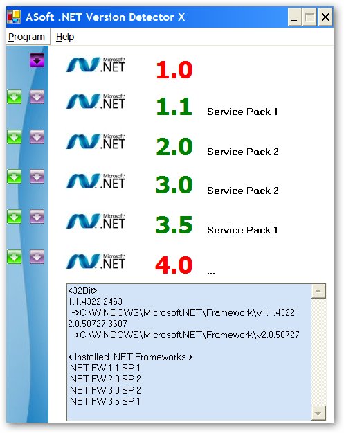

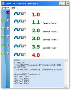

nLite closes down by itself. Why?
I just installed nLite ver. 1.4.9.1
When I run it I select a copy of XP sp2 on my I:xp folder
or
I select the CD and let nLite copy the required files to I:xp2
I click on next
The next screen comes up and then nLite closes by itself.
I have re-booted after installing nLite.
What would cause nLite to close by itself?
Thanks,
Docfxit

The culprit is obviously not .NET Framework, since nLite wouldn't start at all if that were the issue.

docfxit, try removing .NET and reinstalling after a reboot. Let us hear. I run just .NET 4.0. Enjoy, John.
