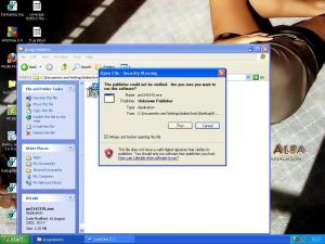

sonickilla Posted August 16, 2010 Posted August 16, 2010 hi im trying to use runonce but everytime i test it the security warning(see attached pic) pops up for a few of the apps how would i get rid tried a few of the regtweaks but none seem to work any help would be great.
Sp0iLedBrAt Posted August 16, 2010 Posted August 16, 2010 (edited) Right-click the application and select Properties. Click the Unblock button and you will remove the warning.Welcome to MSFN. Edited August 16, 2010 by Sp0iLedBrAt
Guest Posted August 17, 2010 Posted August 17, 2010 (edited) nm, I see now it's about the publisher and SpoiledBrat is right. It only needs to be done once per problem file. Edited August 17, 2010 by -X-
Tripredacus Posted August 24, 2010 Posted August 24, 2010 FWIW, I see that AVG is installed. A best practice for any unattended install is to install your antivirus client LAST.
