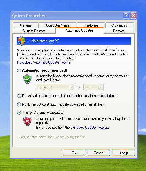

Mina Posted May 12, 2010 Posted May 12, 2010 Hello!I have recently made an unattended windows XP CD using nLite but after installing Windows Automatic Updates are turned off even though I selected Default in nLite.How to fix this?I attached my last session.iniLast Session.ini

johnhc Posted May 12, 2010 Posted May 12, 2010 Hello!I have recently made an unattended windows XP CD using nLite but after installing Windows Automatic Updates are turned off even though I selected Default in nLite.How to fix this?I attached my last session.iniLast Session.iniMina, have you run nLite more than once against the same source? You should run it only once against a fresh copy of your CD files/folders. Did your oeminfo and oemlogo copy work? If not, you may need to add a Cmd /c in front of the copy commands. Please post a screen shot of your Automatic Updates tab of the My Computer Properties. Enjoy, John.
Mina Posted May 13, 2010 Author Posted May 13, 2010 Mina, have you run nLite more than once against the same source? You should run it only once against a fresh copy of your CD files/folders. Did your oeminfo and oemlogo copy work? If not, you may need to add a Cmd /c in front of the copy commands. Please post a screen shot of your Automatic Updates tab of the My Computer Properties. Enjoy, John.Yes I have run nLite more than once against the same source.Oeminfo and oemlogo copy works perfectly Picture what is attached is with "Default" settings: When selected "Download and install" then it is selected "Automatic" in Windows.Selection "Download and install" works for me, but of cource it is interesting to know why "Default" don't work.
Sp0iLedBrAt Posted May 13, 2010 Posted May 13, 2010 You should run it only once against a fresh copy of your CD files/folders There you go; the answer to your problem is in johnhc's post. Get a new copy of XP in your working folder and use Last Session.ini to import your desired settings. Then everything should be fine. What I said about testing in virtual machines (post #2) still applies.Cheers,
