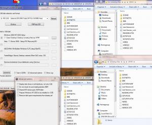

baritone Posted March 30, 2010 Author Posted March 30, 2010 (edited) Where do you select "share"? Why "share"? Describe in details what exactly you are doing.I can barely understand you, with the very limited information you provide...i click on add to usb for xp. then click on advanced options, then click on shared BTS driver pack OEM folder each time i want the feature on each xp folder.i added the driverpack to each xp already like stated. Edited March 30, 2010 by baritone
ilko_t Posted March 30, 2010 Posted March 30, 2010 I see folders $OEM$, this is not OEM.Do you have folder G:\WINSETUP\OEM ?
baritone Posted March 30, 2010 Author Posted March 30, 2010 nowhen i use BTS it makes $OEM$the program didnt make it or what im i doing wrong
ilko_t Posted March 30, 2010 Posted March 30, 2010 In BTS DriverPacks BASE do you select method 1 or 2 (Settings-->DriverPacks method) ?The option in WinSetupFromUSB is intended only for method 2, the fake setup and OEM folder, I should have clarified that.
