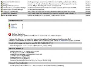

b-man Posted March 27, 2010 Posted March 27, 2010 from 1 of the first nlite disc i made and use i can use Microsoft update (running on this pc now) but now i cant, yet i have used the last session.ini and only ever added things back in to get other programs to work. itunes, nokia phone modem,every time i open the site and download the file then try and install it says install failed??LAST SESSION.INI
johnhc Posted March 27, 2010 Posted March 27, 2010 b-man, did you start with a fresh copy of your CD files/folders? I notice that you have a number of services set to 4 (disabled). Did you change any of these? What says "install failed". Please post a screen shot. Have you tried with your security SW off? Have you changed FW/AV lately? I just went over to CIS (Comodo) v4 and it is sandboxing all kinds of things. BTW, I notice you set up a bunch of NICs. The way I read the nLite Unattended page, you must specify a MAC address for these to work. Did these definitions work for you? Enjoy, John.

b-man Posted March 27, 2010 Author Posted March 27, 2010 (edited) @johnhcyes started with a new sourceserviced are set to disabled are posted in screen shot aswell, although 99% sure they are unneeded for windows update just for remote desktop etc(as far as i can see windows update needs event log, automatic update and BITS running and they all are)in the vmware i havent installed any AV and have my firewall turned offi didnt setup any NIC's thats just what nlite had done for me but i can connected to the internet fine if thats what your asking@Sp0iLedBrAtill add that and try again is there anyway i can just install without have to re nlite it?although it seems i already have that version as my wuaueng.dll in system32 is that version Edited March 27, 2010 by b-man
johnhc Posted March 28, 2010 Posted March 28, 2010 (edited) b-man, the latest version of Windows Update Agent 3.0 can be found in this KB. I suggest you install it and see if it fixes the problem. Is your wuaueng.dll version 7.4.7600.226? I suspect the agent will not correct your problem and I do not know what is going on yet. When you go to WU, it will ask to update the agent if it is not up to date. You said it used to work. Has it worked in your VM or just on the HW? What has changed since then? I also run VMware Server (XP x64) and have no problem with updates (latest agent installed during Windows install). Enjoy, John.EDIT: Please try DLing one of the updates directly from Windows DL Center and see if it will install by running it directly. Thanks.EDIT Again: I would suggest you start SENS (System Event Notification Service). Please look in your event log and see if COM is complaining about SENS not running. Edited March 28, 2010 by johnhc
b-man Posted March 28, 2010 Author Posted March 28, 2010 (edited) i already have the latest version (i am accessing the windows(microsoft) update through the webpage) and yes my wuaueng.dll is version 7.4.7600.226 as i can access the webpage and download the files fine they just wont installits working on my computer that im using now but not the newer nlited xp with the itunes and autologin fixes (havent removed anything else just added more stuff back in 2 get them to work unless i have accidentally hit another option)capped atm but will try at the start of the month or see if i can find a small file to try edit downloaded 1 and installed says it all went good and now isnt in the microsoft update website so definatly something to do with the updater im guessingi did start SENS (before and it still didnt work) but no it doesnt complain about it in the event logi found 1 of my very first lastsession.ini files and compared to my latest and here is the extra settings i have removed where the problem could lie unless its a corrupted install of windows update agentproblem.INI Edited March 28, 2010 by b-man
