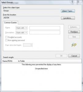

jadtunrau Posted July 10, 2010 Posted July 10, 2010 Can anybody tell me what component breaks the Local Users and Groups in the computer management console? I've tried on both 32-bit as well as 64-bit and I get an "Unspecified Error" (see attachment below) when I click on the Find Now button. I've also attached my inf file.Windows 7 ULTIMATE x86.inf
bensam56 Posted July 10, 2010 Author Posted July 10, 2010 Can anybody tell me what component breaks the Local Users and Groups in the computer management console? I've tried on both 32-bit as well as 64-bit and I get an "Unspecified Error" (see attachment below) when I click on the Find Now button. I've also attached my inf file.Don't remove remote assistance....
