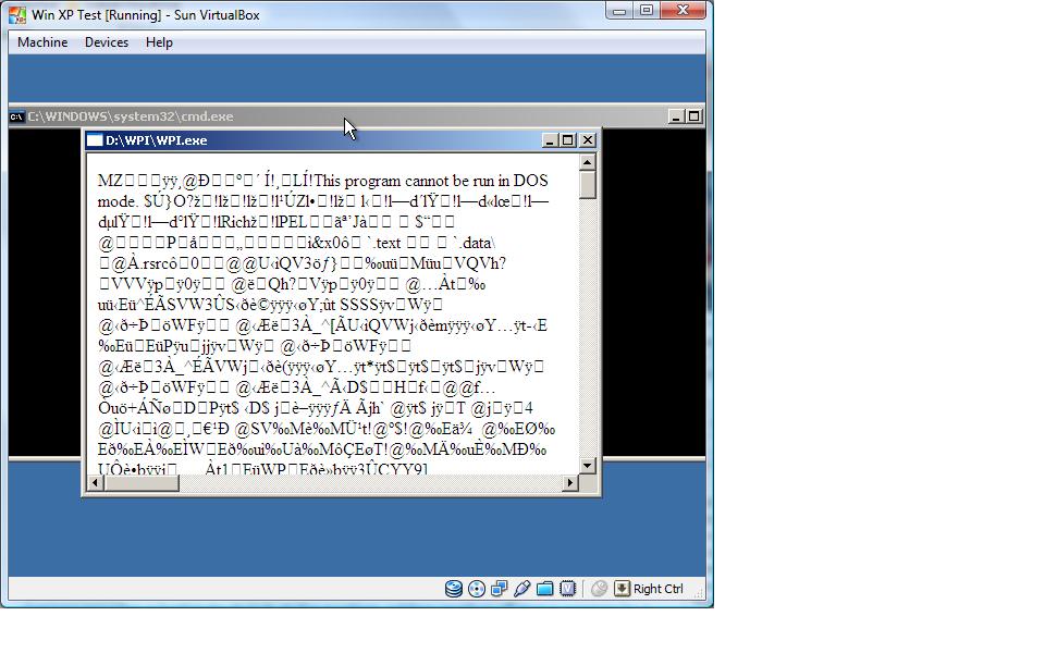

flyboynm Posted February 21, 2010 Posted February 21, 2010 (edited) I did a search, but I couldn't find it. I am trying to automate my installation of various applications onto an N-lite XP SP3 disk. I get through the installation process fine, but when it starts to run WPI, I get a ton of garbage on the screen and an error message stating that WPI cannot run in Dos-Mode. Has anyone else had this come up? How do I fix this issue?Unfortunately, I am building the system as a virtual machine and don't have a screenshot of it right now. I am trying to troubleshoot the automated installer still. LOL (I would like to get that done before I do the WPI fix)Forgot to mention that once Windows XP Pro SP3 gets to the desktop, I can go to the DVD and double click on the WPI html file and it will install without any problems.*solved* When I was adding my driverpacks, my cmdlines.txt in $oem$ was getting modified. I replaced it back with original cmdlines.txt file and it worked. Edited February 21, 2010 by flyboynm
flyboynm Posted February 21, 2010 Author Posted February 21, 2010 (edited) I have a screenshot of the error now. Edited February 21, 2010 by flyboynm
Kelsenellenelvian Posted February 21, 2010 Posted February 21, 2010 How are you calling WPI? Or WHEN?TONS of people use it daily from cmdlines.txt (T-13\T-12)
flyboynm Posted February 28, 2010 Author Posted February 28, 2010 How are you calling WPI? Or WHEN?TONS of people use it daily from cmdlines.txt (T-13\T-12)It was an error in the cmdlines.txt that nlite caused. I found the solution earlier and edited original post stating it was solved.
