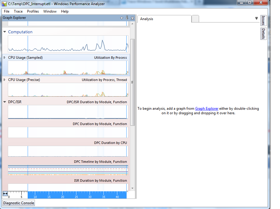

jords16 Posted April 10, 2013 Posted April 10, 2013 I cant find "DPC CPU Usage" or "Interrupt CPU Usage" please help just only this..
MagicAndre1981 Posted April 11, 2013 Author Posted April 11, 2013 @ jords16open the file with xperfview.exe. The new GUI is confusing for new users.

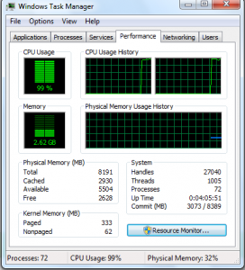

jords16 Posted April 11, 2013 Posted April 11, 2013 my cpu usage still 100% what should i do i followed the all the steps.. i already update my bios and chipset drivers...
MagicAndre1981 Posted April 11, 2013 Author Posted April 11, 2013 where can i locate that file??here:C:\Program Files (x86)\Windows Kits\8.0\Windows Performance ToolkitEDIT: Whilst it hovers around 20-40 a lot of the time now, it still spikes to 100 and even 400-500 quite regularly. everything under 1000µs is not really critical. my cpu usage still 100% what should i do i followed the all the steps.. i already update my bios and chipset drivers...upload the generated .ETL file (compresed as zip/RAR/7z) if you're unsure.
jords16 Posted April 11, 2013 Posted April 11, 2013 where can i locate that file??here:C:\Program Files (x86)\Windows Kits\8.0\Windows Performance ToolkitEDIT: Whilst it hovers around 20-40 a lot of the time now, it still spikes to 100 and even 400-500 quite regularly. everything under 1000µs is not really critical. my cpu usage still 100% what should i do i followed the all the steps.. i already update my bios and chipset drivers...upload the generated .ETL file (compresed as zip/RAR/7z) if you're unsure.i cant upload the DPC_Interrupt.ETL because its to big

jords16 Posted April 11, 2013 Posted April 11, 2013 upload it to skydrive or dropbox and post a link.here is the link https://www.dropbox.com/s/xkj7k9dg6in0qby/DPC_Interrupt.etl
MagicAndre1981 Posted April 11, 2013 Author Posted April 11, 2013 you get periodic ISR/DPC spikes caused by the driver nvm62x64.SYS. So update the NVIDIA nForce 10/100 Mbps Ethernet driver and see if this helps.

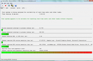

doveman Posted April 11, 2013 Posted April 11, 2013 Hmm, what about this then? The latency's still under 1000 but isn't the high DPC execution time of storport.sys a problem?
