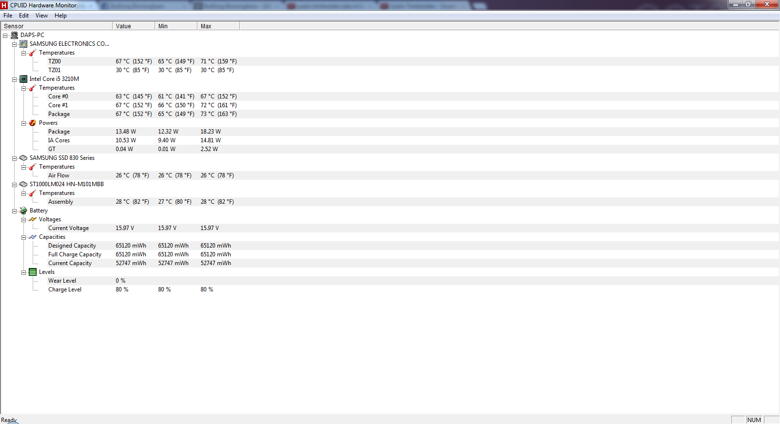

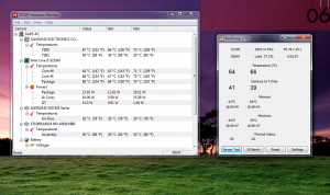

bruvau12 Posted October 4, 2012 Posted October 4, 2012 (edited) I disabled comodo but no influence, I had this problem even after a clean install. I attached the temp of my hardware and the temperature seem high as a result of the load being applied to it? Edited October 4, 2012 by bruvau12
MagicAndre1981 Posted October 5, 2012 Author Posted October 5, 2012 clean the CPU cooler. Also which laptop do you use? Try to update the BIOS and see if you can change the cooler policy so that the cooler fan runs more often to cool down the CPU more.
