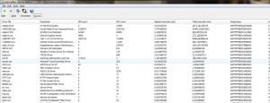

BaSubScribe Posted October 19, 2011 Posted October 19, 2011 Hi Andre: Your tuotrial is truly magical. It worked like a charm using both xperf and Latency Monitor. After running both test, it seems like the culprit is ATAPORT.sys. I have searched this thread for all instances of ATAPORT.sys to see if someone posted a solution. Unfortunately it seems like there was no real solution... unless i just didnt understand what people did to fix theirs. My version of the drivers is "ataport.SYS", "6.1.7600.16385 (win7_rtm.090713-1255)"I am using a Hitachi Deskstar™ 5K3000 for my internal HD and a Western Digital WD My Book 1110 USB External Drive.I have had this set up now for months with no problems until recently my music was popping and hissing and then I noticed one core at full blast which eventually led me to this thread. Are there any other possibilities other than what I have read so far to alleviate this problem? I realy and truly scoured the net for a solution and tried using this thread to do it myself but i am lost at the moment.
MagicAndre1981 Posted October 19, 2011 Author Posted October 19, 2011 ataport is the IDE driver. Do you run your IDE DVD drives or HDDs in PIO mode for example?

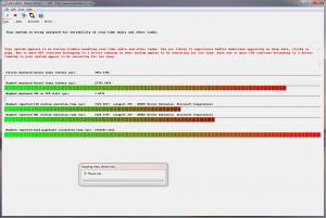

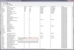

ZenathD Posted October 19, 2011 Posted October 19, 2011 Hi Andre,Great tutorial you made there!I have some serious audio dropouts, and distortions, which is pretty bad since I making music is my hobby.When I run latencymon, I have multiple drivers and processes, which looks like they cause dpc spikes. I have tried to disable the ethernet card, but that does not help. I don't really know where to go from here.Do you think there´s hope for me, or am I totally screwed on this?
MagicAndre1981 Posted October 19, 2011 Author Posted October 19, 2011 please run the xperf trace for 60s and upload the compressed DPC_Interrupt.etl

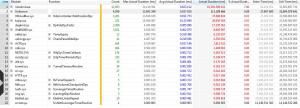

MattMatt Posted November 18, 2011 Posted November 18, 2011 (edited) G'day guys, i know this isn't a hot topic or anything but...I've gotten to the stage where it shows me the DPC CPU usage Summary table, my problem is i have no idea on what "ntoskrnl.exe" is.. If i google it it comes up with "FIX BSOD"..Infact there's lots of stuff in there. What should i do about this? Would a reformat be easier? I don't really want to, but this sound problems getting to me..Is anyone able to help me with my problem? :/ Edited November 18, 2011 by MattMatt
MagicAndre1981 Posted November 18, 2011 Author Posted November 18, 2011 load the symbols and expand the ntoskrnl.exe node until you see a name in the column "function".

MattMatt Posted November 20, 2011 Posted November 20, 2011 can you please zip the ETL and upload it (mediafore.com, Rapidshare.com)?Okay sure!Here The password is MagicAndre1981.Thanks for your help!
MagicAndre1981 Posted November 20, 2011 Author Posted November 20, 2011 what are your power plan settings? It looks you have an issue with the power saving features of your Intel Core 2 Quad. The intelppm.sys and the PpmPerfApplyProcessorState function from the kernel cause the DPC usage.
MattMatt Posted November 20, 2011 Posted November 20, 2011 (edited) what are your power plan settings? It looks you have an issue with the power saving features of your Intel Core 2 Quad. The intelppm.sys and the PpmPerfApplyProcessorState function from the kernel cause the DPC usage.It was just on "High Performance"Could this be related to that i upgraded the processor from a Core 2 Duo to a Core 2 Quad? What should i be changing?Wow changing it to "Balanced" fixed it, there's still a few spikes but videos are watchable now!You're a genius! (;EDIT: Nope, it's ALOT better. But not quite there.. Edited November 20, 2011 by MattMatt
