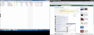

demokid18 Posted December 11, 2010 Posted December 11, 2010 (edited) I was having this slowing issue amd realized my cpu was at 90%+ usage on each core. I followed your guide (great btw, very clear) and these are the results. Can you help me translate the results into knowledge on what I can do to solve??SYS SPECS:ASUS M4A89GTD PRO USB3AMD PHENOM II X2 (X4) 3.2GHz4GB (2x2) G. SKILL RIPJAWS 1600MHz DDR3COOLER MASTER V8WD 500GB GREEN HDD, SEAGATE 1TB 7200RPM HDDWin.7 Home Edition 32 Bit. If I can fix this problem, have 64 bit pro that I will be installing.Just built this system up and ive been having this prblem since.http://img5.imageshack.us/img5/410/lolxb.png Edited December 11, 2010 by demokid18

MagicAndre1981 Posted December 14, 2010 Author Posted December 14, 2010 I was having this slowing issue amd realized my cpu was at 90%+ usage on each core. I followed your guide (great btw, very clear) and these are the results. Can you help me translate the results into knowledge on what I can do to solve??the ATAport.sys is 1 cause. Which IDE/ATAPI drive do you still use? have you installed all drivers from the ASUS page?the HDA driver tells you have an issue with your sound driver. Do you use the latest driver for your "ALC 892 8-Channel High Definition Audio CODEC"?the ndis.sys is part of network. Do you use the Realtek® 8111E Gigabit LAN controller? Are you using the latest driver?
demokid18 Posted December 15, 2010 Posted December 15, 2010 I was having this slowing issue amd realized my cpu was at 90%+ usage on each core. I followed your guide (great btw, very clear) and these are the results. Can you help me translate the results into knowledge on what I can do to solve??the ATAport.sys is 1 cause. Which IDE/ATAPI drive do you still use? have you installed all drivers from the ASUS page?the HDA driver tells you have an issue with your sound driver. Do you use the latest driver for your "ALC 892 8-Channel High Definition Audio CODEC"?the ndis.sys is part of network. Do you use the Realtek® 8111E Gigabit LAN controller? Are you using the latest driver?Updated my chipset drivers yesterday (problem has occured since then). Just now updated my HDA driver and LAN driver. What do you mean by IDE/ATAPI drive? I understand it has to do with storage but what you mean by the drive part?Thanks btw Andre!

MagicAndre1981 Posted December 17, 2010 Author Posted December 17, 2010 Updated my chipset drivers yesterday (problem has occured since then). can you undo this and use the old ones?What do you mean by IDE/ATAPI drive? I understand it has to do with storage but what you mean by the drive part?IDE = the old 40pin parallel connection cable.

demokid18 Posted December 17, 2010 Posted December 17, 2010 (edited) Updated my chipset drivers yesterday (problem has occured since then). can you undo this and use the old ones?What do you mean by IDE/ATAPI drive? I understand it has to do with storage but what you mean by the drive part?IDE = the old 40pin parallel connection cable.Both the drives I use are SATA. 1 is a Seagate Baracuda ST31000333AS ATA, and the second is a Western Digital Green drive WDC WD5000AACS-00G8B1 ATA both using ATAPI-8.I've reinstalled the drivers from ASUS' site and disc several times in all combinations. Have also reinstalled the OS using 32 and 64 bit Home Edition and Pro. (Win. 7) I've run the test several times with ataport.sys being the number 1 cause each time. Do you think this is a Windows 7 problem specifically? Wondering if I went back to XP if the problem would be solved. Edited December 17, 2010 by demokid18
