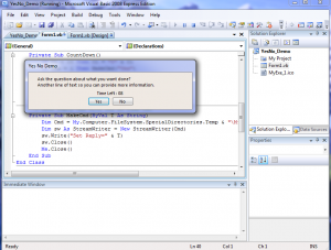

I notice while HTA was running and clicking Start button, the start menu will disappear.
This does not happen using autoit.
Simple comparsion :
HTA in post 14 : 244 lines - 14 comment line =230 lines
Autoit: 134 lines - 1 comment line = 133 lines
Thanks again for the inspiration.
Screenshot: countdown >10 sec
Last 10 sec ...

I also wrote this 39 lines of code with comments in Vb.net 2008
Imports System
Imports System.IO
Public Class Form1
Dim Yes
Dim C1 = 30
'-> Stsrt Timer
Private Sub Form1_Load(ByVal sender As System.Object, ByVal e As System.EventArgs) Handles MyBase.Load
Timer1.Start()
End Sub
'-> Yes
Private Sub Button1_Click(ByVal sender As System.Object, ByVal e As System.EventArgs) Handles Button1.Click
Yes = 1
End Sub
'-> No
Private Sub Button2_Click(ByVal sender As System.Object, ByVal e As System.EventArgs) Handles Button2.Click
Yes = 2
End Sub
'-> Start The Timer
Private Sub Timer1_Tick(ByVal sender As System.Object, ByVal e As System.EventArgs) Handles Timer1.Tick
CountDown()
End Sub
'-> Count Down
Private Sub CountDown()
If C1 < 10 Then C1 = "0" & C1
If Yes = 1 Then MakeCmd("Yes")
If Yes = 2 Then MakeCmd("No")
If C1 = 0 Then MakeCmd("Timed-Out")
Counter.Text = "Time Left : " & C1
C1 = C1 - 1
End Sub
'-> Make Reply Cmd With Yes No Time Out
Private Sub MakeCmd(ByVal T As String)
Dim Cmd = My.Computer.FileSystem.SpecialDirectories.Temp & "\MyReturn.cmd"
Dim sw As StreamWriter = New StreamWriter(Cmd)
sw.Write("Set Reply=" & T)
sw.Close()
Me.Close()
End Sub
End Class
post-5386-0-08237000-1325744605_thumb.pn
VB.Net 2006 Source Code
YesNo_Demo.zip
