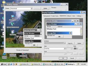

there is no tab for saving a theme in windows 98/me like there is in xp.
here is a pic with the theme i saved applied and the desktop properties and theme manager open so maybe you can see what i mean.
i get nothing but classic colors and there not even the same,the colors in the theme manager are correct and the system properties are not.
thanks for any help on this.
