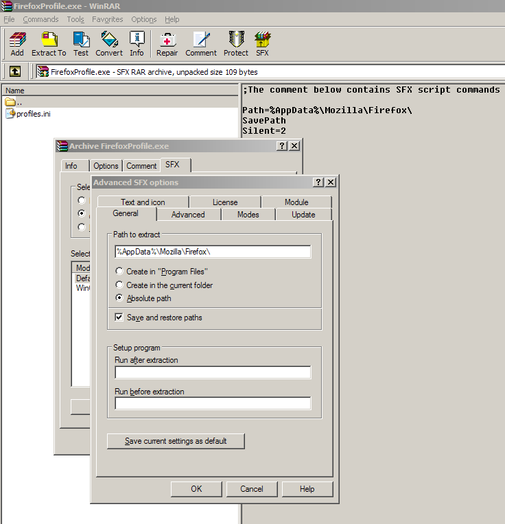

Guest Posted May 27, 2009 Posted May 27, 2009 Use $OEM$ folders and WinRar SFX archives. I do something similar so I'll give you an example.Let's take the folder structure of my theoretical XP CD...MYXPCD-i386-%OEM%--$1 <---- stuff in $1 will be copied over to the operating system drive---finalize <--- in here i but my batch, reg, winrar sfx archives, etcIn my finalize folder above I place a file called FirefoxProfile.exe that will silently extract to my %appdata% folder. Here's how..Firefoxprofile.exe is a WinRar SFX archive and I'll let a picture explain it better than words can... My profile.ini gets copied over to my %AppData%\Mozilla\Firefox\ directory!As for shortcuts, WinRar has that ability too. I'm not very familiar with is but if u press the help button in the Advanced SFX Options > Add Shortcut tab, it will be explained to you.In nLite, go to the unattended, runonce tab and add this command -> %SystemDrive%\finalize\FirefoxProfile.exeFinally make sure OemPreinstall is set to enabled in the nLite unattended section so that the $OEM$ folder contents get copied over.
