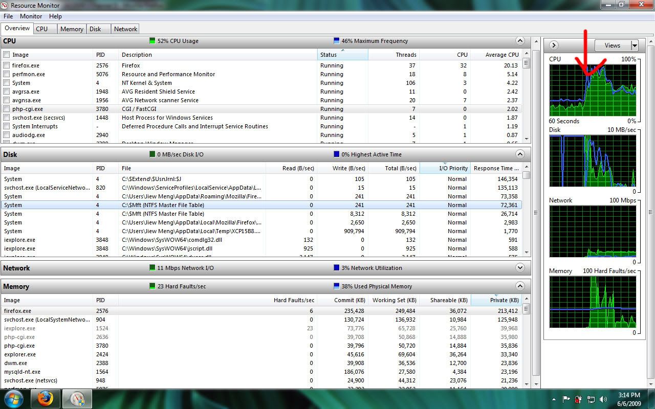

iceangel89 Posted June 6, 2009 Author Posted June 6, 2009 (edited) hmm i used AVG now, and it stills happens... so ... using process monitor i can see the graph and what processes use how much resources "now". so when it hangs i dont think i can switch to process monitor so ... is there a process monitor log or something? because it might be too late to see what process is responsible after the hang ends. and intel drivers? i dont see 1 for Windows 7. do i use the 1 for Vista? do i dl the Intel INF?UPDATE:i just got another hang this time resource monitor says FireFox hangs everything else seems fine but i noticed something, u see the image, the arrow... when it hangs there is nothing in the Disk section of resource monitor ... everything else seems to be like inactive ... i expected a spike but all graphs see to be flat and low. after the hang everything then spikes Edited June 6, 2009 by iceangel89
Sonic Posted June 6, 2009 Posted June 6, 2009 ...you can find latest ahci driver with typing "f6flpy6488" on intel website , download section ... 8.8 is the latest version at the moment ... I have updated mine using device manager with inf downloaded ... rebooted .. no hangs since ...yes vista x64 drivers are compatible seven x64 (almost ...)and I confirm it's solution.
