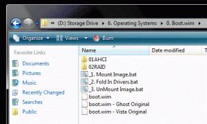

To Prepare:
Install the WAIK
You will need the basic routines that the kit contains
This is what My Environment looks like

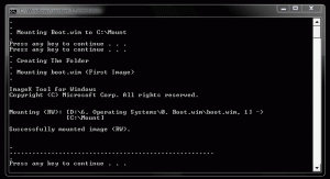

Step 1: Mount The Image
Create this batch file
_1. Mount Image.bat
echo off
cls
set __EXPAND="%Programfiles%\Windows AIK\Tools\amd64\Servicing\Expand.exe"
set __PEIMG="%ProgramFiles%\Windows AIK\Tools\PETools\peimg.exe"
set __IMAGEX="%ProgramFiles%\Windows AIK\Tools\amd64\Imagex.exe"
set __PKGMGR="%ProgramFiles%\Windows AIK\Tools\amd64\Servicing\pkgmgr.exe"
set __Mount=C:\Mount
Echo Off
Cls
Echo .
Echo .
Echo . Mounting Boot.wim to %__Mount%
Echo .
pause 1
pause 0
Echo .
Echo . Creating The Folder
mkdir "%__Mount%"
Echo .
Echo . Mounting boot.wim (First Image)
Echo .
%__IMAGEX% /mountrw ".\boot.wim" 1 "%__Mount%"
Echo .
Echo ......................................................
Echo .
pause
The 2 pauses are there in case you execute this script by accident.
The mount folder can be changed to anything you want but
besure to change it in the other batch files as well.
If you are using a 32-bit OS while preping the image,
change \amd64\ in the paths to \x86\
as in ="%ProgramFiles%\Windows AIK\Tools\x86\Imagex.exe"
Vista's boot.wim has 2 images, both images should be changed the same way.
I have not yet tried just updating image 2.
Image selection is controlled by the image number
%__IMAGEX% /mountrw ".\boot.wim" 1 "%__Mount%" <-- for image 1
%__IMAGEX% /mountrw ".\boot.wim" 2 "%__Mount%" <-- for image 2
You can also use names but it must be exact. Numbers are easier.
Ghost 12 has only 1 image.
this is what it looks like

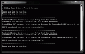

Step 2 - Fold in Drivers
There are a number of things that you can do to the image while its mounted.
I use it mainly to preinstall my drivers.
I need the MediaShield RAID drivers for boot.wim to see my drives.
This is how I slipstream them in.

Echo . Adding Boot Drivers From OS Drivers
Echo .
pause 2
pause 1
pause 0
Echo .
Echo .
%__PEIMG% /inf=".\01AHCI\nvstor32.inf" "%__Mount%\Windows"
Echo .
Echo .
%__PEIMG% /inf=".\02RAID\nvrd32.inf" "%__Mount%\Windows"
Echo .
Echo .
pause
As I posted in another thread, boot.wim is 32-bit (I have yet to see a 64-bit)
Do not attempt to slipstream in 64-bit drivers, 32-bit OS will not understand them.

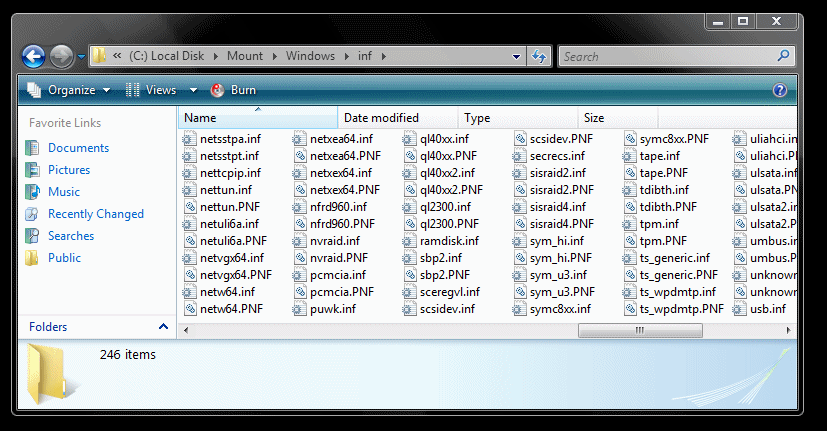

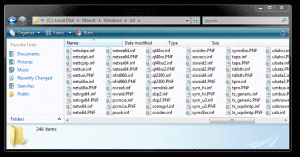

Step 3 - Unmount the Image
For me, I like to verify my work...
Here is what the inf folder looked before the slipstream
And like this after the batch file is run

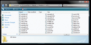

and here is the image now...
Note the OEM0.inf and OEM1.inf

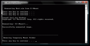

So we are good, now create this batch file
_3. UnMount Image.bat
echo off
cls
Echo Off
Cls
Echo .
Echo .
Echo . Unmounting Boot.wim from %__Mount%
Echo .
pause 2
pause 1
pause 0
%__IMAGEX% /commit /unmount "%__Mount%"
Echo .
Echo .
Echo .
Echo .Removing Temporary Mount Folder
Echo .
RmDir /S /Q "%__Mount%"
pause

When you follow the directions above, do you see the OEMx.inf files?
If not, then the drivers are not installed.
