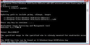

ner Posted May 14, 2009 Posted May 14, 2009 (edited) Having REAL problems creating my imageThis is my command:rd /s/q C:\PE\winpe_x86cd c:\Program files\windows aik\tools\petoolscall copype.cmd x86 C:\PE\winpe_x86pausecd C:\Program Files\Windows AIK\Tools\x86\Servicing\Dism.exe /Mount-Wim /WimFile:C:\PE\winpe_x86\winpe.wim /index:1 /MountDir:C:\PE\winpe_x86\mount\pausecd C:\Program Files\Windows AIK\Tools\x86\Servicing\Dism /image:C:PE\winpe_x86\mount /Add-Package /PackagePath:C:\Program Files\Windows AIK\Tools\PETools\x86\WinPE_FPs\en-us\WinPE-HTA_en-us.cabPAUSECopy c:\MakePE3\Windows\System32\*.* C:\PE\Winpe_x86\Mount\Windows\System32Copy c:\MakePE3\Icon\*.* C:\PE\Winpe_x86\ISOpausecd C:\Program Files\Windows AIK\Tools\x86\Servicing\Dism /Unmount-Wim /MountDir:C:\PE\winpe_x86\mount /Commit PAUSEcopy c:\PE\winpe_x86\winpe.wim c:\PE\winpe_x86\ISO\sources\boot.wimPAUSEcd C:\Program Files\Windows AIK\Tools\x86\oscdimg -n -bc:\PE\winpe_x86\etfsboot.com c:\PE\winpe_x86\ISO c:\PE\winpe_x86\winpe_x86.isoPAUSEand i get this error:see attachment Edited May 14, 2009 by ner
ner Posted May 15, 2009 Posted May 15, 2009 (edited) Many Thanks Jazkal, Its was that problem. Thanks.Fully created a working version now, although i was unable to install any packages, as it said the package was not able to install for the veriosn?Anyway, woked for what i needed it to do, which was to install images via Ghost 11.5Here is my C<D File for anyone that needs it....RD /s/q C:\PE\winpe_x86cd "c:\Program files\windows aik\tools\petools"call copype.cmd x86 C:\PE\winpe_x86pausecopy c:\PE\winpe_x86\winpe.wim c:\PE\winpe_x86\ISO\Sources\boot.wimpausecd "C:\Program Files\Windows AIK\Tools\x86\Servicing"Dism /Mount-Wim /WimFile:C:\PE\winpe_x86\ISO\Sources\boot.wim /index:1 /MountDir:C:\PE\winpe_x86\mountpausecd "C:\Program Files\Windows AIK\Tools\x86\Servicing"Dism /image:C:\PE\winpe_x86\mount /Add-Package /PackagePath:"C:\Program Files\Windows AIK\Tools\PETools\x86\WinPE_FPs\en-us\WinPE-HTA_en-us.cab"Dism /image:C:\PE\winpe_x86\mount /Add-Package /PackagePath:"C:\Program Files\Windows AIK\Tools\PETools\x86\WinPE_FPs\en-us\winpe-legacysetup_en-us.CAB"Dism /image:C:\PE\winpe_x86\mount /Add-Package /PackagePath:"C:\Program Files\Windows AIK\Tools\PETools\x86\WinPE_FPs\en-us\winpe-mdac_en-us.CAB"Dism /image:C:\PE\winpe_x86\mount /Add-Package /PackagePath:"C:\Program Files\Windows AIK\Tools\PETools\x86\WinPE_FPs\en-us\winpe-scripting_en-us.cAB"Dism /image:C:\PE\winpe_x86\mount /Add-Package /PackagePath:"C:\Program Files\Windows AIK\Tools\PETools\x86\WinPE_FPs\en-us\winpe-setup_en-us.cAB"Dism /image:C:\PE\winpe_x86\mount /Add-Package /PackagePath:"C:\Program Files\Windows AIK\Tools\PETools\x86\WinPE_FPs\en-us\winpe-wds-tools_en-us.CAB"Dism /image:C:\PE\winpe_x86\mount /Add-Package /PackagePath:"C:\Program Files\Windows AIK\Tools\PETools\x86\WinPE_FPs\en-us\winpe-wmi_en-us.CAB"Dism /image:C:\PE\winpe_x86\mount /Add-Package /PackagePath:"C:\Program Files\Windows AIK\Tools\PETools\x86\WinPE_FPs\en-us\winpe-PPPOE_en-us.CAB"PAUSECopy D:\MakePE3\Windows\System32\*.* C:\PE\Winpe_x86\Mount\Windows\System32Copy D:\MakePE3\Icon\*.* C:\PE\Winpe_x86\ISOpausecd "C:\Program Files\Windows AIK\Tools\x86\Servicing"Dism /Unmount-Wim /MountDir:C:\PE\winpe_x86\mount /Commit PAUSEcd "C:\Program Files\Windows AIK\Tools\x86"oscdimg -n -bc:\PE\winpe_x86\etfsboot.com c:\PE\winpe_x86\ISO c:\PE\winpe_x86\winpe_x86.isoPAUSE Edited May 15, 2009 by ner
