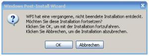

SirHaschke Posted January 15, 2009 Author Posted January 15, 2009 Great.Now my "Panagon" software works fine :-)But now i have another error.If i activate "Load desktop before starting installation" and i start WPIi see the screen with the applications and the counter (30 sec).After the counter is 0 WPI will be closed.If i start WPI again i get the message like in the picture.If i click "Abbrechen" i get the same result (counter 30 sec. -> 0 -> WPI closed).If i click "OK" WPI beginns to install the applications.If i deactivate "Load desktop before starting installation" and i start WPI allapplications will be install after the 30 sec.Is this a bug?
mritter Posted January 15, 2009 Posted January 15, 2009 That's what it is supposed to do. That option assumes you just did a fresh Windows install, desktop loads, then WPI starts.It is not meant to be used from the desktop in a testing situation. It will do nothing. A RunOnceEx key is being set to run at next desktop load. If you run WPI from desktop, hit Install, it will exit. If you do a reboot, once the desktop is loaded, WPI will start.
