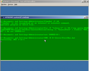

leozack Posted July 9, 2009 Author Posted July 9, 2009 (edited) You'll note over at kurt_aust's thread you keep mention step 1-4 : that is to use nlite seperately ot slipstream the source, and then booogies wmp integrator to integrate wmp11 - then back this up as your working directory and apply your addons/hotfixes in a seperate nlite stage after that. This is what I've done.Tonight I've tried about 3 builds (takes nearly an hours each! First time I messed the path to my FirstRun.bat since I made a folder called Extra on the cd where I put it, along witht he dotnet3in1.exe and my ie7wmp11.reg file and tooltipfixer setup file since that requires dotnet I have to run it after the dotnet install. It also totally failed to logon automatically even though in nlite I set autologon count to 1 not 0.So I tried again and this time I fixed the path to be %SOURCE%Extra\FirstRun.bat. I also noticed on the "autologon" section of nlite there was a pulldown for which user which was on none - I set it t Administrator. I also saw a tickbox saying "blank password" so I ticked that too.The next build DID automatically logon (maybe because I selected administrator in the pulldown - maybe because I ticked black password) but when it was installing the password field had 1 * in both fields - I left it there and it all worked - but this is undesirable, I'd prefer it to literally remain blank as always - else I might aswell make ANOTHER user innlite users page, like "Install" with a password of "installer" and set that to be the autologon once so it can ru the batchfile. That way when you install you can still leave the administrator password as properly blank?The autorun file did run, but after it installed dotnet and tooltipfixer it exited - it didn't copy any of the contents of %source%i386 to c:\i386 which it should. But I just realised that's because it was using %LOCAL% not %SOURCE% (I created %LOCAL% and set it to be %SOURCE%Extra. OK I can sort that then.It also made a $OEM$ folder with the cmdlines.txt in which it hasn't done before ... all beacuse the autologon? :/ If that's always going to be there I might aswell move my stuff into there from the Extra folder I made? :/So the only issue I think now is the autologon ... do I need to tick the blank password tickbox in nlite? Can I haev the passwrd fields literally blank during install as usual or must it haev that * in them?I've also included some screenshots of the event log application errors - mostly complaining IIS isn't installed?And 1 screenshot showing the batch file complaining that Timeout isn't a valid command - if oyu check my lastsession.ini you see it is part of guirunonce ahead of the command to run the batchfile. I thought that was right? :/LAST_SESSION.INI Edited July 9, 2009 by leozack
johnhc Posted July 10, 2009 Posted July 10, 2009 leozack, the Timeout command problem is because XP does not have the command - sorry, I now remember Kurt_Aust talking about that. In W2000, Kurt_Aust uses Ping -n 11 127.0.0.1 > nulI don't understand what this does other than cause some delay. Again, Kurt_Aust thinks it is needed and I just leave it. If your AutoLogon is working, I would leave it as is. I create my real user account, assign a PW and set it to never expire. I leave AutoLogon run always. I have also used boooogy's WMP11 Slipstreamer then run nLite, but since the running of it is integrated into nLite I just place the WMP11 installer and updates in the hot fix section - see my Last Session. I was not correct in suggesting that you could place you copies into the $OEM$ file, since you want to copy the entire I386 folder. I think it would work, but you would need to place two copies into your source folder. I thought disabling OEMPreinstall (which you have) would kill the $OEM$ folder, but it does seem I remember seeing something about AutoLogon and the $OEM$ folder, but can't find it right now. I don't have any help on your errors, except some questions and suggestions. Have you installed ASP.NET from MS? Perhaps the .NET installer you are using is doing something bad. Would you consider my previous suggestion to use the .NET installer and updates from the MS DL Center? For more information on the errors, click on the link provided in the message. I have found some very good information there - and some worthless. I get a rash of errors from an application I install, a couple of warnings about a Print function and a couple of DCOM errors which seem to be common in my system until I install a fix. I assume mine are coming before my batch file gets the fix installed. I get no more errors as time goes by. The * in the password is the indication for blank. Hope this helps, John.
leozack Posted July 10, 2009 Author Posted July 10, 2009 (edited) OK I just did a new build. Yes - I found out w2003 ahs the timeout function so like kurt_aust, I added a ping 127.0.0.1 > nul which for your information pings that IP which is the loopback IP of your local pc so it's pretty quick, and > nul says output is sent to nul - aka - nowhere - aka nothing is shown onscreen. nul could be a textfile you want to save the output to if you wanted.Anyway I found if i don't tick "blank password" but DO select administrator from the account pulldown and autologon set to 1, it DOES logon once, and I don't get the * during setup - which is good.My batch file also ran - apart from my xcopy! Which I realised was missing the *.* so I'm now running another install attempt with that in there to see if it all works.All the errors from my previous post are still ine vent log though :/My batchfile, the dotnet installer, the tooltipfixer installer, and my 2 regfiles are all in $OEM$ since autologon creates that folder and puts cmdlines.txt in there I thought I'd use it instead of my own Extra folder.My batchfile :@echo offclscolor 2aset LOCAL=%SOURCE%$OEM$echo.echo Installing .NET 3-in-1echo.%LOCAL%\DotNetFX3In1.exeecho.echo Installing Tooltip Fixerecho.%LOCAL%\ToolTipFixer2.0.0.exe /Secho.echo Copying local i386 source to c:\i386echo.if not exist c:\i386 md c:\i386xcopy "%SOURCE%i386\*.*" "c:\i386\" /e /i /h /q /k /cecho.echo Registering c:\i386 sourceecho.regedit /s %LOCAL%\I386.regecho.echo Configuring IE7 and WMP11echo.regedit /s %LOCAL%\IE7WMP11.reg--------------------OK that finished and the batchfile executed perfectly - all ok!However - I still have those eventlog errors (but thenI did notice a section innlite about installing IIS or not, and mine is set to default, which I guess is no)I also found MSWU had the following updates waiting : kb926139 kb963707 kb969897.If you look in my hotfix list you see I have 926139 and 969897 in there - so dunno what they're showing up. And 963707 is for firefox only so irrelevant on ym virtual pc - shouldn't happen on real pc without firefoxLAST_SESSION.INI Edited July 10, 2009 by leozack

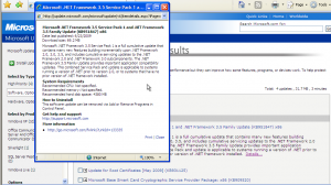

johnhc Posted July 10, 2009 Posted July 10, 2009 leozack, you did not answer the questions I asked in my last reply, so I will again suggest that you quit using the 3 in 1 .NET installer and use the real files from MS DL Center. Place them in your batch file as Kurt_Aust shows. If this does not prevent the errors, then remove all the AddOns you have and see if that does. Update KB963707 is not a Firefox update, it is a .NET update (Firefox support) and I suspect MS does not have a method to detect that Firefox is installed on your system. I got the request to install the x64 version of the update on my real machine (never nLited), and I installed it to stop the notifications. The other two updates that were in your nLite hot fix section, but WUD still told you about them, could be some that nLite is unable to integrate. Please do a search in these forums for the KB numbers and see if they are. If so, then place the installers into your batch file as Kurt_Aust does. Are you testing under a virtual system? If not, you should consider one. Enjoy, John.

johnhc Posted July 12, 2009 Posted July 12, 2009 leozack, the last batch file of yours I looked at used the guts of the AddOn, not the actual AddOn. This is essentially the same as using the MS installers. My comment on 'watching' the long install is - Don't Watch! MS update 963707 can easily be found at the MS DL Center by searching for KB963707. On using Vista to build for XP. Good question. Some have had problems and it is known that integrating an SP does not work. I say give it a try and let us know your experience. Vista 32 or 64 bit, same thoughts. I hope you do know that when you are only changing your batch file or the files it calls, you do not need to run nLite again, except to build an ISO. Enjoy, John.

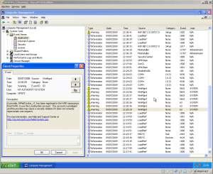

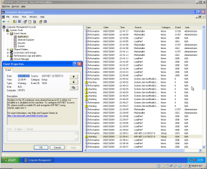

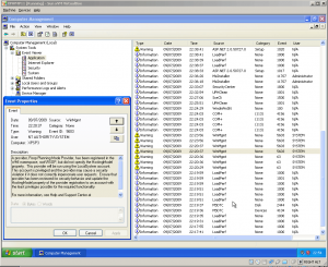

leozack Posted July 18, 2009 Author Posted July 18, 2009 (edited) Did you take a look a those appwarnings? Since they're warnings not errors it should be safe to ignore them? Pics 1-3 are during windows install bu pics 4-10 are during the .net install I guess.I just checked on this build and it current wants the following updates from MSUcumulative update for ie7 kb969897xp update kb959772security udpate for xpsp3 kb952069.net 3.5 sp1 & .net 3.5 family update kb951847root certificates kb931125base smart card cryptographic service provider package kb909520gpo client side extentions kb943729But the IE7 update KB969897 belongs to WindowsServer2003.WindowsXP-KB969897-x64-ENU.exe which I am trying to do in firstrun.bat - but as you read above - when it is run it says update/setup.exe is not a valid win32 application! I dunno where to go next other than adding the following to my firstrun.bat - kb959772 kb952069 kb951847 kb931125 kb909520 kb943729 (I hoped these would be included in Xables update pack since I'm using the newest XUpdatePack-SP3-v1.0.18.7z http://xable.net/xp-sp3-update-pack-changelog.php)I've just realised of course I shouldn't be adding updates to my postinstall batchfile, I should be integrating them. Only updates t things not integrated should be done post install - aka dotNET stuff. Lets try a build like that.For the record, I can't find ANY REFERENCE to this update on MS DLC - .net 3.5 sp1 & .net 3.5 family update kb951847. I've attached a screenshot of it but the links don't exist and searching for it yields nothing too! O_o /confused Edited July 18, 2009 by leozack
