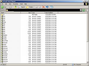

I think that I know what he is talking about. I am trying to work with Dell Optiplex GX280 drivers for reimaging a harddrive and *not* installing the drivers until AFTER the setup. Anyways, the GX280's chipset drivers are ALL cab files, no inf files. I have attached a screenshot of the folder containing the files.
