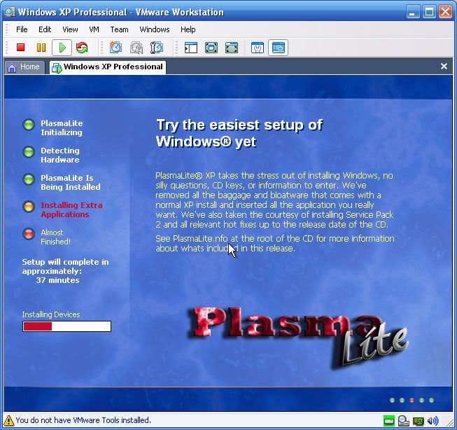

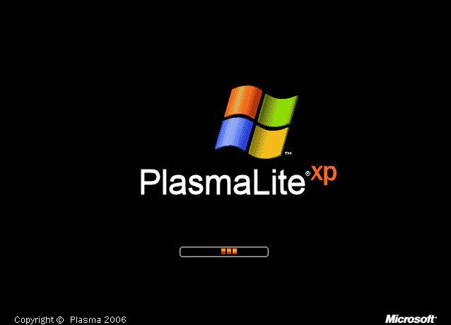

Add a custom startup logo and change the colur of the progress bar..
I also replace the "winntbbu.dll" to give a custom setup screen...
Plasma
I'm so glad i asked ! =))
Nice Placstic wrap effect there ;D. I've used third party tools to accomplish similiar things, and then i ask, how did you make these?
Resource editor and swap images inside the files? Im on xp x64 and there's no xpize support or such =(
Edited by TranceEnergy
  • Author
Yep I used Resource Hacker and Photoshop, and swapped out the images. :D
The setup dll took ages to get it looking right but I think it was worth the effort!
For the Kernel files I used BootEditor to put the images in!
Plasma
