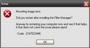

Hi,
I tried to open my VISTA CD (included SP1, copied manually from DVD to HDD) and get an error "Mounting Image Error" (see Uploaded Image for Details).
I've installed it by the first installation and had restartet the machine.
Now I tried to reinstall VLite but it doesn't solve the problem.
My Host System is Windows XP.
What can I do?
Edited by RegisterForOneQuestion
This is a bug which gets reported now and then and only known solution is to reinstall XP SP2 (or SP3 now) and it will work.
Don't remove Filter Manager with nLite if you do.
If you figure out the cause without reinstall let us know.
