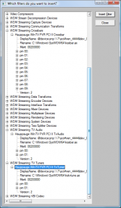

Ekjaker Posted October 3, 2008 Posted October 3, 2008 (edited) still missingWDM Streaming CrossbarWDM Streaming TV AudioWDM Streaming TV Tunereven with your newest setup.Whats going wrong?Thank youwimaI'm afraid I don't have a lot of time to spare the next couple of days. I hope to be looking deeper into this after the weekend. For now, I did find this link that explains clearly how these elements cooperate. Might be helpful: http://msdn.microsoft.com/en-us/library/ms783782(VS.85).aspxFrom what I was able to make out of it (and as you mentioned above), the "WDM Streaming Crossbar" relies on the ksxbar.ax file, and the "WDM Streaming TV Tuner" needs KSTVTune.ax. For the audio I dont really know. The 2 files mentioned should be on the Windows 2008 as they are included in the batch-file. I guess it might be a registry issue like Xordos mentioned in one of the above posts.In the meantime, could you post a screenshot of the graphedit in Vista? thx Edited October 6, 2008 by Ekjaker
wima Posted October 3, 2008 Posted October 3, 2008 Here is the screenshot (vista x64, english):Greetingswima
