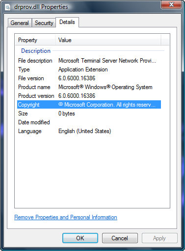

It's properties:
I haven't checked this throughly, but I hope that nuhi will look at this, check any additional dependencies this remaining DLL has and fix this little bit anoying bug ;)
