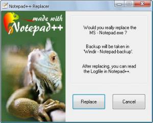

vampus8 Posted January 8, 2008 Share Posted January 8, 2008 (edited) Follow these instructions to set up an unattended install of Notepad++ and replace Windows Notepad with Notepad++. Alternatively, you could just replace the files in your windows installation source but this method has the advantage that it can be run from WPI. Special thanks to Olivio over at the German nLite board and Sourceforge whose AutoIT code I modified to make the replacement tool. Here's his original post: http://sourceforge.net/forum/message.php?msg_id=4641563Basically, the replacement tool copies the notepad++ launcher into c:\windows\, c:\windows\system32\, c:\windows\system32\dllcache, (and a couple other directories if they exist on your computer) replacing notepad.exe in each of those directories. The trick is that it temporarily disables windows file protection on those files so that you don't get error boxes when you try to copy the files and so that Windows doesn't panic and revert them back to the original notepad.exe. The install process also creates a log file called Notepad_Replacement.log in your home drive (whatever drive your home directory is store in, c:\ for me) and a backup of your original notepad.exe file at C:\windows\Notepad-backup\notepad.exe. Note: If you run the replacement utility twice it will overwrite your backup notepad.exe with the replacement file.------------Instructions------------Setup:1) Download the Notepad++ installer from http://notepad-plus.sourceforge.net/uk/download.php .2) Download the Notepad++ Launcher from http://notepad-plus.sourceforge.net/uk/download.php .3) Download the replacement tool exe file from http://www.mediafire.com/?4mzdxey9n1j (or http://www.mediafire.com/?czmnbomsegg if you prefer the original .au3 file)4) Extract notepad.exe from the Launcher and put it in the same directory as the replacement tool.Install:5) Run the notepad++ installer with the switch /S6) Run the replacement tool.Voila! A perfectly unattended way to install Notepad++ and completely replace Windows Notepad. Edited January 8, 2008 by vampus8 Link to comment Share on other sites More sharing options...
Jolli Posted May 3, 2008 Share Posted May 3, 2008 (edited) Link to Sourceforge is dead!For those who don´t wont a log file and without a Gui is here a stripped autoit code:--> for the silent installation.#include <array.au3>; load given notepad files in ArrayDim $Files[7] = [@WindowsDir & "\servicepackfiles\i386\notepad.exe", _ @WindowsDir & "\source\WinXP\i386\notepad.exe", _ @SystemDir & "\dllcache\notepad.exe", _ @SystemDir & "\notepad.exe", _ @WindowsDir & "\notepad.exe", _ @HomeDrive & "\i386\notepad.exe", _ @HomeDrive & "\i386\NOTEPAD.EX_"]_ArrayDisplay($Files);backup MS-Notepad.exe$WinBU=DirCreate(@WindowsDir & "\Notepad-backup")If FileExists($Files[4]) Then FileCopy($Files[4], $WinBU, 1)If FileExists($Files[5]) Then FileCopy($Files[5], $WinBU, 1)If FileExists($Files[6]) Then FileCopy($Files[6], $WinBU, 1);temporary disables protection for MS-Notepad.exe$Srcfile=@ScriptDir&"\notepad.exe"For $Element In $Files If FileExists($Element) Then DllCall(@SystemDir & "\SFC_OS.DLL","dword", 5, "dword", 0, "wstr", $Element, "dword", -1) Next If FileExists($Element) Then FileCopy($Srcfile, $Element, 1)ExitFor the outstanding reader the compiled "MS-Notepad_Replacer_noGUI+Log.exe" --> for the silent installation.http://uploaded.to/?id=apw67d==========================================Here is a picture from the MS-Notepad-Replacer with a Gui:Here the autoit code from the MS-Notepad-Replacer with Gui for a running System:#cs ----------------------------------------------------------------------------AutoIt Version: 3.2.8.1Author: OlivioWith friendly Help from German nLite Board from Zio82draw, AspirinJunkie[url="http://www.german-nlite.de"]http://www.german-nlite.de[/url]Script Function: Temporary disables Protection for MS-Notepad.exe and replace it with the Notepad++ Launcher. #ce ----------------------------------------------------------------------------;~~~~~~~~~~~~~~~~~~~~~~~~~~~~~~~~~~~~~~~~~~~~~~~~~~~~~~~~~~~~~~~~~~~~;~~~~~~~~~~~~~~~~~~~~~~ - TranslateSection Start - ~~~~~~~~~~~~~~~~~~~~~~~;~~~~~~~~~~~~~ !! Only between " " , otherwise it will crash !! ~~~~~~~~~~~~~~~~~~;~~~~ i.e. "Notepad++ Replacer" become "Notepad++ Remplaçant" in france ~~~~~~~~~;~~~~~~~~~~~~~~~~~~~~~~~~~~~~~~~~~~~~~~~~~~~~~~~~~~~~~~~~~~~~~~~~~~~~;---GUI-----------------------------$Npprpl = "Notepad++ Replacer" ; Titel of GUI, if you want to translate $Quest1a = "Would you really replace the"$Quest1b = " MS - Notepad.exe ?"$State1a = " Backup will be taken in"$State1b = "'Windir - Notepad-backup'."$State2a = "After replacing, you can read"$State2b = " the Logfile in Notepad++."$Buttn_r = "Replace"$Buttn_c = "Cancel";--- 1. MSG - Box--------------------$Warn = "Warning!"$Quest2a = "An open session of the notepad.exe excist"$Quest2b = "Please save your Session right now !"$Quest2c = "Otherwise the Session will be closed in 20 Seconds";--- 2. MSG - Box--------------------$State3 = "Successfully Replaced"$Quest3a = "MS-Notepad.exe are all replaced by Launcher"$Quest3b = "Would you read the Logfile now in Notepad++ ?";~~~~~~~~~~~~~~~~~~~~~~ - TranslateSection End - ~~~~~~~~~~~~~~~~~~~~~~~~~;~~~~~~~~~~~~ !! Don´t translate under this line anything else!! ~~~~~~~~~~~~~~~~~;~~~~~~~~~~~~~~~~~~~~~~~~~~~~~~~~~~~~~~~~~~~~~~~~~~~~~~~~~~~~~~~~~~~~Opt("TrayIconHide", 1)Opt("GUICloseOnESC", 1)#include <GuiConstants.au3>$Pic = (".\npp.logo1.gif")$Quest1 = $Quest1a & @CRLF & $Quest1b$State1 = $State1a & @CRLF & $State1b$State2 = $State2a & @CRLF & $State2b$date = (@MDAY&"."&@MON&"."&@YEAR&" - "&@HOUR&":"&@MIN&":"&@SEC)GuiCreate($Npprpl, 384, 281,-1, -1 , BitOr($GUI_SS_DEFAULT_GUI, $WS_EX_TOPMOST))GUISetIcon("Icon_3.ico") GuiCtrlCreatePic($Pic, 0, 0, 164, 314)$Group_2 = GuiCtrlCreateGroup("", 175, 5, 200, 180)$Button_3 = GuiCtrlCreateButton($Buttn_r, 181, 210, 85, 40)$Button_4 = GuiCtrlCreateButton($Buttn_c, 283, 210, 85, 40)GUICtrlCreateLabel($Quest1, 210, 35)GUICtrlCreateLabel($State1, 210, 83)GUICtrlCreateLabel($State2, 207, 133)GuiSetState()While 1 $msg = GuiGetMsg() Select Case $msg = $GUI_EVENT_CLOSE ExitLoop Case $msg = $Button_4 Exit Case $msg = $Button_3 _replace() Exit EndSelectWEndExitFunc _replace() $rpfile=".\" & $npx $ServPf=@WindowsDir & "\servicepackfiles\i386\" & $npx $WinSwI=@WindowsDir & "\source\WinXP\i386\" & $npx $dlCaN=@SystemDir & "\dllcache\" & $npx $SysNp=@SystemDir & "\" & $npx $Wnpx=@WindowsDir & "\" & $npx $npx="notepad.exe" $log = FileOpen('Notepad.log', 2) FileWriteLine($log, $date & " - " & "Start the Notepad Replacement Logfile" & @CRLF & @CRLF) If ProcessExists("notepad.exe") > 0 Then MsgBox(32, $Warn, $Quest2a & @CRLF & $Quest2b & @CRLF & $Quest2c, 20) While ProcessExists($npx) ProcessClose($npx) Wend If ProcessClose($npx) > 0 Then FileWriteLine($log, $date & " - " & "OK - open Notepad Process successfully closed" & @CRLF & @CRLF) EndIf Else FileWriteLine($log, $date & " - " & "No open Notepad Process to close" & @CRLF & @CRLF) EndIf ;backup Microsoft Notepad.exe $WinBU=@WindowsDir & "\Notepad-backup\notepad.exe" If FileExists($Wnpx) Then FileCopy($Wnpx, $WinBU, 1) If FileCopy($Wnpx, $WinBU, 1) > 0 Then FileWriteLine($log, $date & " - " & "OK - Notepad successfully copied in Notepad Backup" & @CRLF & @CRLF) Else FileWriteLine($log, $date & " - " & "No notepad.exe in 'WinDir'" & @CRLF & @CRLF) EndIf $HmDr1=@HomeDrive & "\i386\notepad.exe" If FileExists($HmDr1) Then FileCopy($HmDr1, $WinBU, 1) If FileCopy($HmDr1, $WinBU, 1) > 0 Then FileWriteLine($log, $date & " - " & "OK - notepad.exe successfully copied in Notepad Backup" & @CRLF & @CRLF) Else FileWriteLine($log, $date & " - " & "No notepad.exe in 'HomeDrive\i386'" & @CRLF & @CRLF) EndIf $HmDr2=@HomeDrive & "\i386\NOTEPAD.EX_" If FileExists($HmDr2) Then FileCopy($HmDr2, @WindowsDir & "\Notepad-backup\NOTEPAD.EX_", 1) If FileCopy($HmDr2, @WindowsDir & "\Notepad-backup\NOTEPAD.EX_", 1) > 0 Then FileWriteLine($log, $date & " - " & "OK - NOTEPAD.EX_ successfully copied in Notepad Backup" & @CRLF & @CRLF) Else FileWriteLine($log, $date & " - " & "No NOTEPAD.EX_ in 'HomeDrive\i386'" & @CRLF & @CRLF) EndIf ;temporary disables protection for notepad.exe Dim $Array[7] $Array[0] = $ServPf $Array[1] = $dlCaN $Array[2] = $SysNp $Array[3] = $Wnpx $Array[4] = $HmDr1 $Array[5] = $HmDr2 $Array[6] = $WinSwI For $Element In $Array If FileExists($Element) Then DllCall(@SystemDir & "\SFC_OS.DLL","dword", 5, "dword", 0, "wstr", $Element, "dword", -1) Next ;notepad replacing in given dir If FileExists($ServPf) Then FileCopy($rpfile, $ServPf, 1) If FileCopy($rpfile, $ServPf, 1) > 0 Then FileWriteLine($log, $date & " - " & "OK - Launcher successfully copied in 'servicepackfiles\i386'" & @CRLF & @CRLF) Else FileWriteLine($log, $date & " - " & "No notepad.exe in 'servicepackfiles\i386'" & @CRLF & @CRLF) EndIf If FileExists($dlCaN) Then FileCopy($rpfile, $dlCaN, 1) If FileCopy($rpfile, $dlCaN, 1) > 0 Then FileWriteLine($log, $date & " - " & "OK - Launcher successfully copied in '\dllcache'" & @CRLF & @CRLF) Else FileWriteLine($log, $date & " - " & "No notepad.exe in '\dllcache'" & @CRLF & @CRLF) EndIf If FileExists($SysNp) Then FileCopy($rpfile, $SysNp, 1) If FileCopy($rpfile, $SysNp, 1) > 0 Then FileWriteLine($log, $date & " - " & "OK - Launcher successfully copied in 'systemdir'" & @CRLF & @CRLF) Else FileWriteLine($log, $date & " - " & "No notepad.exe in 'systemdir'" & @CRLF & @CRLF) EndIf If FileExists($Wnpx) Then FileCopy($rpfile, $Wnpx, 1) If FileCopy($rpfile, $Wnpx, 1) > 0 Then FileWriteLine($log, $date & " - " & "OK - Launcher successfully copied in 'Windir'" & @CRLF & @CRLF) Else FileWriteLine($log, $date & " - " & "No notepad.exe in 'WinDir'" & @CRLF & @CRLF) EndIf If FileExists($HmDr1) Then FileCopy($rpfile, $HmDr1, 1) If FileCopy($rpfile, $HmDr1, 1) > 0 Then FileWriteLine($log, $date & " - " & "OK - Launcher successfully copied in 'HomeDrive\i386\'" & @CRLF & @CRLF) Else FileWriteLine($log, $date & " - " & "No notepad.exe in 'HomeDrive\i386'" & @CRLF & @CRLF) EndIf If FileExists($HmDr2) Then FileCopy($rpfile, $HmDr2, 1) If FileCopy($rpfile, $HmDr2, 1) > 0 Then FileWriteLine($log, $date & " - " & "OK - Launcher successfully copied to 'HomeDrive\i386\NOTEPAD.EX_'" & @CRLF & @CRLF) Else FileWriteLine($log, $date & " - " & "No NOTEPAD.EX_ in 'HomeDrive\i386'" & @CRLF & @CRLF) EndIf If FileExists($WinSwI) Then FileCopy($rpfile, $WinSwI, 1) If FileCopy($rpfile, $WinSwI, 1) > 0 Then FileWriteLine($log, $date & " - " & "OK - Launcher successfully copied in 'Windir\source\WinXP\i386'" & @CRLF & @CRLF) Else FileWriteLine($log, $date & " - " & "No NOTEPAD.EX_ in 'Windir\source\WinXP\i386'" & @CRLF & @CRLF) EndIf FileWriteLine($log, $date & " - " & "End of Notepad Replacement Logfile") FileClose($log) If MsgBox(262212, $State3, $Quest3a & @CRLF & @CRLF & $Quest3b) = 7 Then Exit EndIf ShellExecute(@ScriptDir & '\Notepad.log')EndFuncFor the outstanding reader the compiled "MS-Notepad-Replacer-Gui.exe" in zip include the Notepad++launcher and the Notepad++ picture for the Gui.see the picture: http://s3.directupload.net/file/d/1257/o8qhbanz_jpg.htm--> for a running system.http://uploaded.to/?id=4w4w4pJolli Edited November 7, 2008 by Jolli Link to comment Share on other sites More sharing options...
