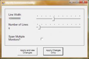

I got tired of fiddling with the registry to tweak out the Vista Screensavers and ive been meaning to try my hand at C#. This thread is the result of that attempt. Ive clipped together various code snippets from around the web and this is what i came up with:
The actual utility:
scr.exe (no source yet -its embarrassing bad)
Heres the problem. the utility works perfectly if you already have the settings in the registry but if the keys dont exist before you run it, it crashes

got it

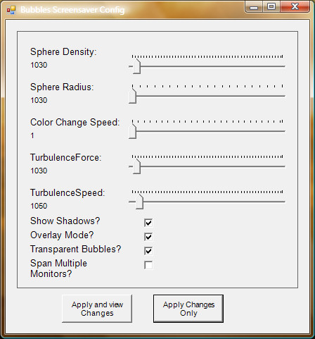

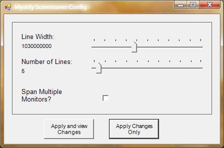

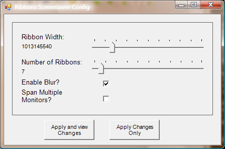

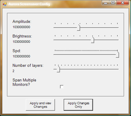

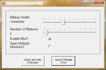

RibbonWidth = (int)RibbonsKey.GetValue("RibbonWidth");
should have been
RibbonWidth = (int)RibbonsKey.GetValue("RibbonWidth", 1030000000);
because if it failed the data type wasnt int so therefore would fit where i was trying to put it.
it now works 100% and i went ahead and made all 4
Aurora.exe
Bubbles.exe
Mystify.exe
Ribbons.exe
if only there was a way to actually build them into the screensavers control panel
but either way they work great
