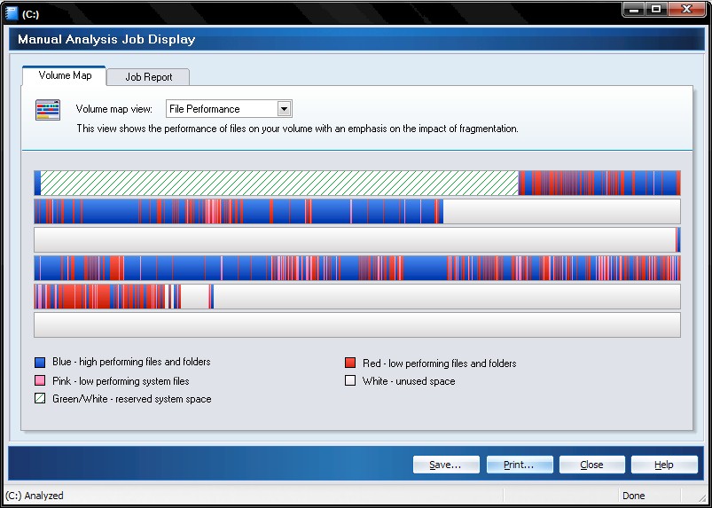

I have both installed, but I don't use dual boot because always there's some "interference" between them, mainly with AV programs. I use Partition Magic, but there's a drawback too, you need a partition with FAT32. I created one with 1Gb and installed Win98, only to support the multiple Boot. I have a primary HD where they are installed and a secondary HD shared to both systems. Works perfectly and you can see (measure) the performance from both OS, since I have the same programs installed on them. Even this way, Vista makes changes on XP partition, changing NTFS structure. Images below
Traditional NTFS (windows 2000) with a large (green/white) reserved area:
