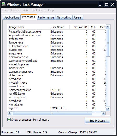

i noticed that when i hibernate my PC. when i start it, it boots normally as if its been shut down. and when it goes to the desktop, it will be blank for a long time. when i see task manager, i get as in the attachment (thats after quite awhile - some processes start to have usernames). alot of processes under "Username" is blank at first.

well im not sure if its a virus but what you can do if you havent as yet is remove the avg and comodo and restart and then see if the problem persists . Then you will know if its your new apps. causing this problem for starters.
That is to say that your problem started when you changed the firewall and antivirus

looks like there is some spyware in there. post a HijackThis log.
