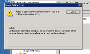

I have a 2003 Network with several DCs.
Few days before when I try to open the GPO Edit (GPMC), it comes out error message
Is there anybody can help me resolve this problem??
Thanks. :blushing::blushing:

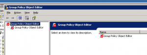

The problem happened since I de-promo a DC and promo again. After I finish the dcpromo, I found the gpmc comes out the error. I check on the gpmc that it only have the "Default Domain policy" and "Default Domain Controller Policy" all other gpos are lost. I tried to add again, after I added a policy when I want to edit, it comes out the above message.
Is there any way I can cleanup the old policies and re-create new one?? Or any utilities can re-pair the GPO system??? It seems like I screwed up the Active Directory!!!

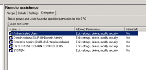

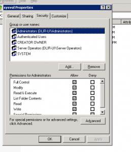

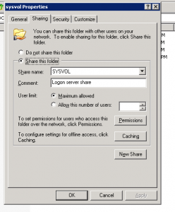

What rights does your user account have (do you have schema admin rights in the domain?), and what permissions does your account have against the sysvol folder and subfolders on the DC?
  • Author
These are the information from the DC, hope it helps.
I'm using "Administrator" to login so it suppose have all the rights needed. Also, I can edit the Default GPO and before the problem started, I can create new GPOs.
Thanks again for the help.
