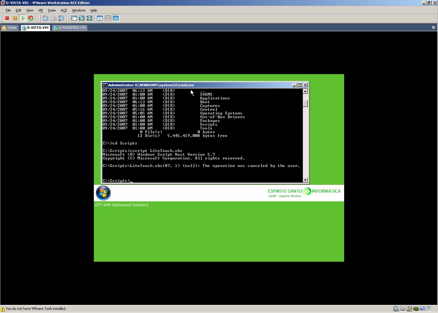

I've created a build and a deployment point via BDD 2007.
Now on the target machine (a vmware in this case) I start WinPE via WDS.
I map the dristo share and try to run the litetouch.vbs script.
I get the following error in attach.
Can some1 help me?
A good start would be to go to line 87, char 1 in the litetouch.vbs script and see what it point at. Prolly the easiest way of moving forward....
Hi there.
This was just a biiig misunderstood I believe.
I was launching a custom WINPE 2.0 that I've done, from WDS. Then I realized that I should use LiteTouch.wim that BDD generates! :)
Now it's working just fine.
