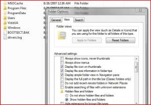

maxXPsoft Posted September 2, 2007 Posted September 2, 2007 (edited) I never said it don't still work but I studied that quite awhile with the restructuring of folders since I have the obligation to copy/move everything correctly with my programs as best as I can.The Users folder is setup similar to what the Docs and Sets was so they are saying use that instead. Its only because of rogue apps that have Docs and Sets hard coded that they haven't completely eliminated it as the explanation above shows. People are changing their apps to conform but it takes time.Tic 'Show hidden..' and you tell me if you see Documents and Settings.Apparently you didn't look at my pic above. I always show all files and extensions and thats Vista M8 with the Docs and Sets with a shortcut link on it.EDIT: BTW, In Vista you see the shortcut link on that folder where in XP it don't have it. Edited September 2, 2007 by maxXPsoft
