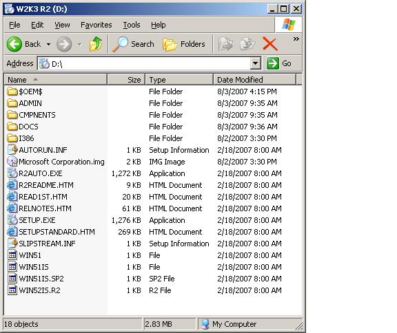

Thanks for the response, but unfortunately it did not work. I still think it may be the way i had the batch files set up. My File structure on CD winnt.sif, cmdlines.txt, batch.cmd and RunOnceEx.cmd file below. My install works perfectly. there are no errors but when I log in the first time it is requesting the second disc. I need to stop that from running on startup and i think i can set up the batch then. BTW I am using a W2k3 Volume disc that SP2 already integrated.
$OEM$
ADMIN
CMPNENTS
DOCS
I386
AUTORUN.INF
Microsoft Corporation.img
R2AUTO.EXE
R2README.HTM
READ1ST.HTM
RELNOTES.HTM
SETUP.EXE
SETUPSTANDARD.HTM
SLIPSTREAM.INF
WIN51
WIN51IS
WIN51IS.SP2
WIN52IS.R2

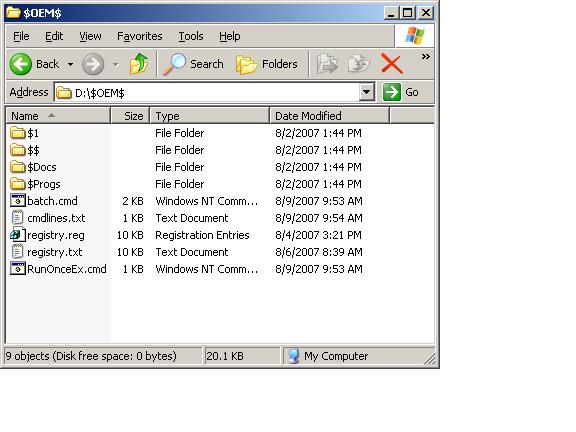

Does the RunOnceEx window even come up @ all? Can I see a screenshot of what is inside the $OEM$ folder? At the VERY LEAST, you should have the RunOnceEx window coming up saying "Configuring Your System"...If that doesn't even come up then there is a problem in you CMDLINES.txt file (You wrote commands.txt in your post but I hope you meant cmdlines.txt )
Hm, I think I just saw something that may fix this...
REMOVE the EXIT at the end of batch.cmd
OK, should I put the exit in the RunonceEx or just leave it as is? And yes the file is cmdlines.txt...
I attached screenshot or $oem$ also.

No go. I am thinking back to beginning of this thread that I need to suppress the request for the second CD. Could the Autorun.inf be casuing and issue. When i copied it over I didn't overwrite the file from disc 1.
[AutoRun]
open=setup.exe
icon=setup.exe,0
Should it be the one off of the second disc? BTW I tried running just the RunOnceEx.cmd off of the desktop after it was loaded and it did not work.
