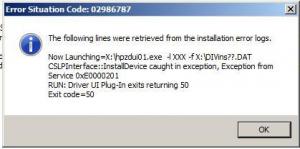

the error and last session file while installing the HP driver software are attached
Setup detects the printer but eventually says device setup failed to complete.
it was working with vlite RC1. changes from RC1 are
Added components
1. Windows Sidebar and Gadgets
2. Windows Aero Theme
3. Windows Photo Gallery
4. Desktop Window Manager
5. Microsoft DFS Replication
6. Changed language settings from English(US) to English(India)
Removed components
7. Windows Portable Devices
beats me. any ideas? could it be due to 5 or 6?
Update: 1. reversed point 6 - didnt work. 2. disabled DFS DWM and started windows installer from services.msc - didnt work.
3. adding back 7. + adding back HP drivers + reversing 6 . let's see if it works.
Last_Session.rar
Edited by pallavsuri
Well i've just given up using HPs buggy software and using built in drivers of Vista. :realmad: Working fine now. :thumbup
