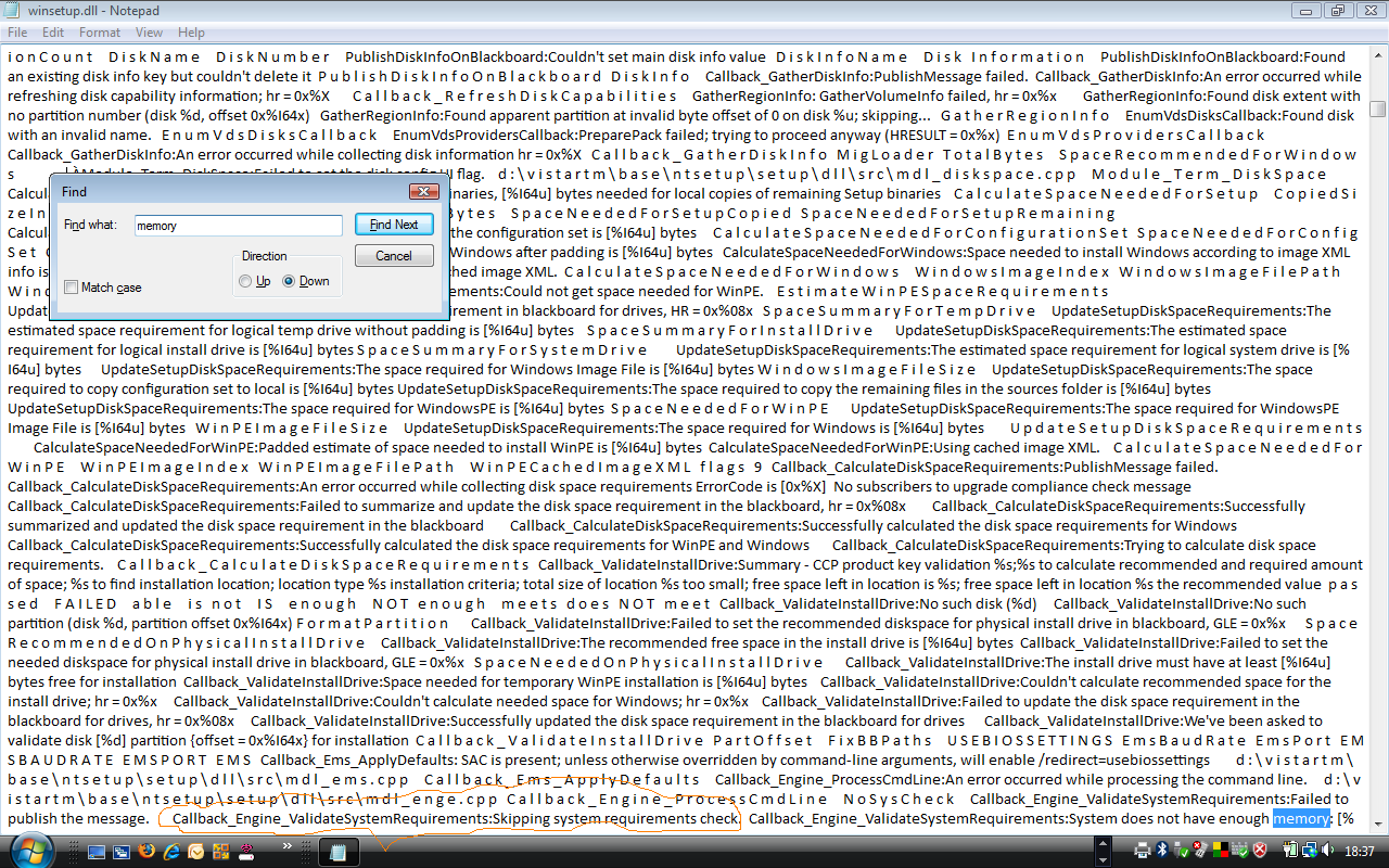

Is there a way of running Vista on a PC with 256Mb of RAM, but with 4Mb of shared memory for the on-board graphics? The 256Mb option in TWEAKS patches winsetup.dll, but inside this DLL, there seems to be a call for "Skipping system requirements check." [see enclosed pic].
The function is from "Callback_Engine_ValidateSystemRequirements". Is there a way to implement the "Skipping system requirements check." - either by using a custom setting somewhere, or by some undocumented switch that can be passed to setup.exe from the unattend.xml?

I try this this morning, but nothing work ! Windows vista ask me again that there is not enough memory
I put the DLL file in dvdsource\sources\ : nothing
Then i mount the install.wim and replace the original one : dvdources\mount\windows\system32\oobe\ : nothing
Windows doen't install itself
MayBe did we need to put this dll file into the Boot.wim ?
If anyone try this, please share a little simple tuto for others !!
