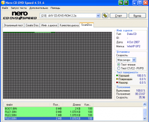

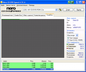

  2. Edited Oct.4: 2.47, I tested it with native cdimage.exe and with cdimagegui beta 3 that has cdimage 2.47 I found a simple way to reproduce it: I make iso image from three files of 1 mb each with two different software: cdimage.exe and mkisofs. I user the following keys (that I dig out from hflip script): CDIMAGE.EXE -l"WinXP-SP2" -h -j1 -m -bcdroot\boot.bin cdroot "cdimageiso.iso" mkisofs -relaxed-filenames -d -D -N -R -J -jcharset cp1251 -no-emul-boot -no-iso-translate -boot-load-size 4 -b "boot.bin" -o "mkisofs.iso" -V "WinXP-SP2" cdroot First (cdimage) iso image size is 3352576 bytes. Second (mkisofs) iso image size is 3670016 bytes. Then I mount iso image to virtual cd drive and check disk with nero cd-dvd speed scandisk tool. First (cdimage) image ends exactly at the last file, second (mkisofs) image has a blank space (a few green squares) after the last file. The images are attached. I came across a workaround during this posting. I get a dummy file of 300kb, issue a command copy /b cdimageiso.iso + /b dummyfile cdimageplus.iso and I receive cdimageplus.iso file of the same extra length. It seems to mount to virtual drive ok and nero check shows a good picture. Edited Oct.14: I burned cdimageplus.iso ok with Nero7, it works fine, windows setup goes ok. Nero cd/dvd speed scandisk shows a nice picture (like the right one attached). However it is a mystery for me where I'm wrong
